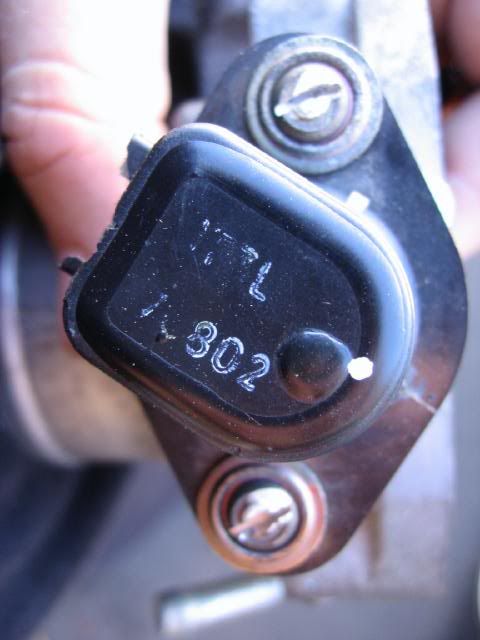

    im thinking thats it cause, it sounds dumb of me but i broke my tbs and i couldnt find out how to take it out cause it doesnt have screws so i but a b18 throttle body on it and now it has this problem.. so i didnt know if that would have anything to do with it

    When you do the DPFI to MPFI you have to switch the outside two wires on the TPS plug because the daul-point TPS works the opposite way as the multi-point. If you dont switch them youll be rich at idle and lean at WOT. This is how you get them "rivets" out.

    the car ran and drove wonderful! thanks for the help:D
