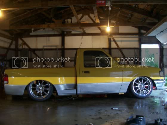

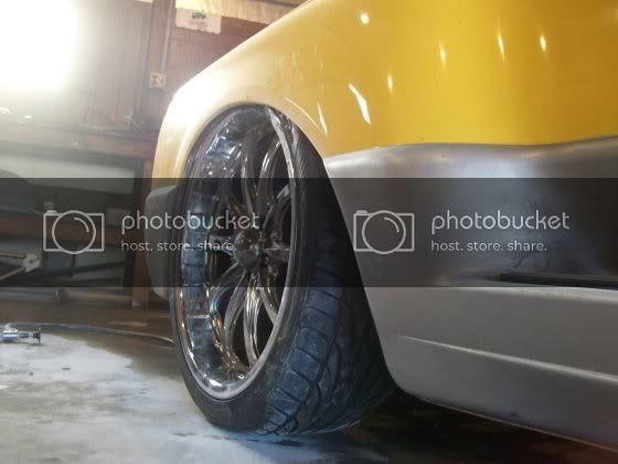

came home and sanded the rear fender lips down quite a bit because the tires were rubbing against them. after plenty of sanding, i got it to so the tires didnt hit. heres 2 pics of it aired down to show you it sits:
i THINK i may go get a set of thinner spacers to see if that may help. if they dont work then oh well. thats about it. just waiting on the KP 4-link to arrive now!!

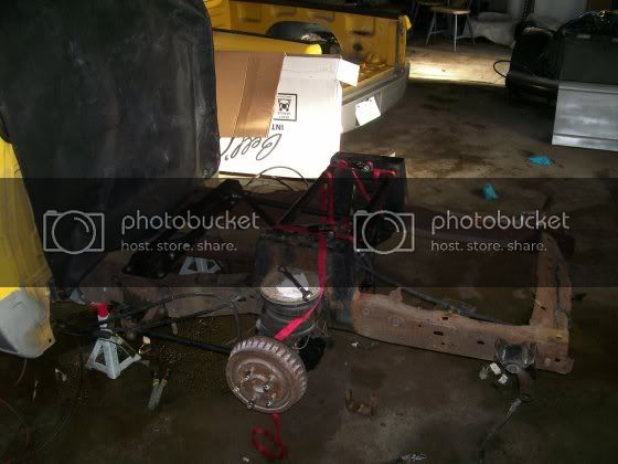

well its been a bit since ive updated but things are going slow but thats ok. anyways, the 4-link is on. well 95% done but its essentially done. i just gotta tighten up everything pretty good. heres a pic:
sorry for the bad pic but ahh well. friday i PLAN on getting some POR-15 and start on that nasty mess...lol.

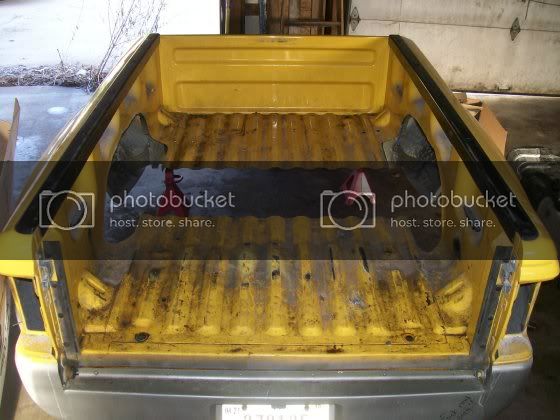

yeah it was a nasty mess. i wanna try to put everything under the bed to try to clean up the bed and i wanna be able to haul my crap in the bed instead of cramming everything in the cab. heres a pic of the bed and what i got for room (note: stock gas tank IS staying in the bed somewhere):

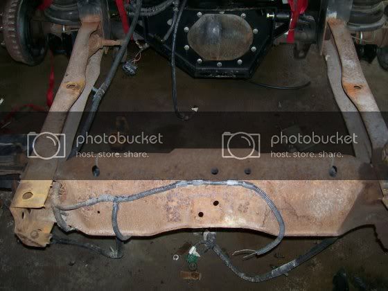

and heres what little room i have under the bed to put things:
i know i can put my compressor (Viar 480) in between the frame rails but i have NO clue what to do with the air tank. if you got any ideas (pics would be awesome too) of how i can mount my tank, please post it!!

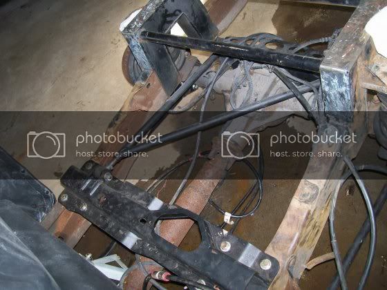

anyways, so the 4-link is finally all bolted in finally. heres a pic:
its a really good kit. i definately suggest it if anyone like me doesnt know how to weld.

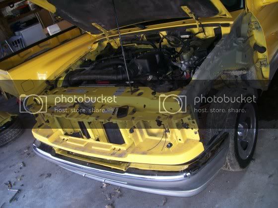

after i was confident in that everything was tightened and looked ok, i decided to start tearing into the front end to start cutting and moving and removing things. heres a pic:
i still gotta take the passenger fender off, but 1 damn bolt hiding behind the air box is holding me up but by then i was just too tired to mess with the truck anymore. thats about it.

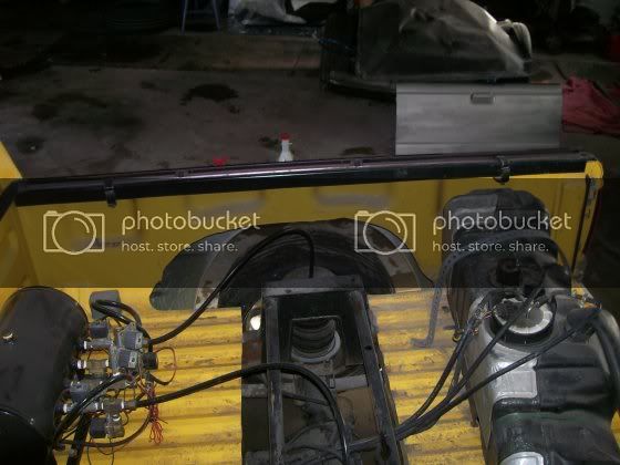

oh, i got a buddy coming over with his welder and we are gonna mount the air tank in the back between the frame rails this coming week. this will give me room in the bed of my truck to actually haul my crap to car shows instead of craming everything into the cab....lol. oh, and he may also be giving me his old fuel cell as well.
I see my car in the second pic in the first post. :D
It was fun helping him figure out if the fenders were going to hit the first few days.

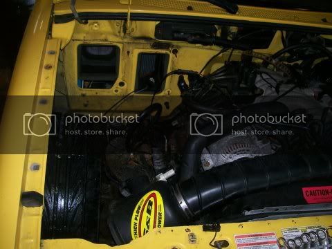

i got the dash pulled loose so i can work on getting the HVAC box removed. its been a pain in the ass to remove and frankly im glad its getting removed. this has pretty much been the reason why ive been lazy because i just dreaded removing this damn thing. anyways, i FINALLY got the damn thing removed on the engine side so now i have a big hole in my engine bay:
i just gotta yank whats left of the box inside the cab of the truck which isnt gonna be tough to do.

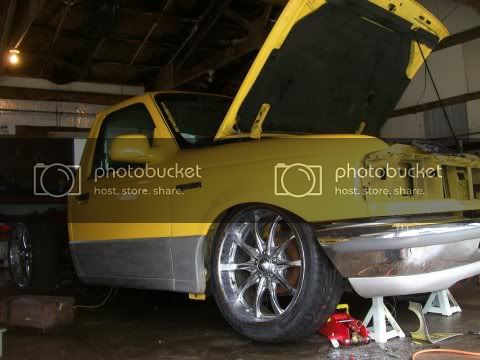

then i cut the inner fender out on the passenger side so the wheels (20" Boss 308) wont rub on it. after that was done i decided to put a wheel on to see how it looks along with the fender. heres the result:
thats with a jack up underneath the ibeam holding it up but im sure that it will sit a bit lower once the truck is on the ground but i dunno. we will see. so far im content as to the way its looking.

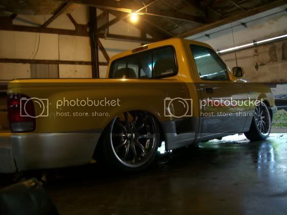

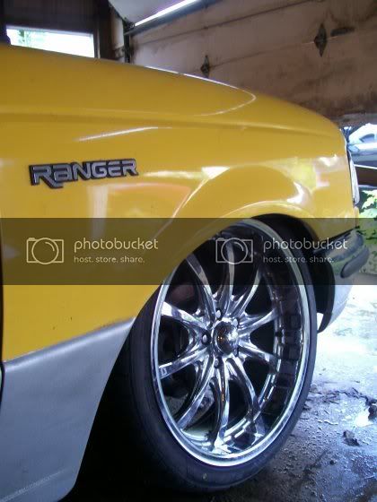

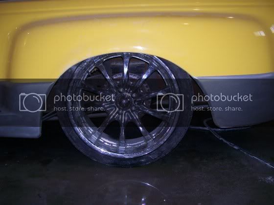

i got all the cutting done on the drivers side in the front done. after all that was done, i decided to throw on all the wheels. before i did that tho, my buddy Phil came over and made a hose attachment for me so i can lift the truck up and down using the shop compressor. we got that made and tested it and the truck was able to lift up and down with the air bags which helps alot now! i also put new fittings on the bags in the front and rear. anyways, so i bolted up a fender and put the bed on to see what it will look like. over all it looks ok except the front sits higher than the rear but i guess that will be like that until i put my radius arm x-member relocators on. alsothe driver side wheel doesnt camber in like the passenger side does but i will do some more investigating on that later on. anywho, here are a few pics to see what it looks like:
side view:
rear-ish view:
front wheel:
