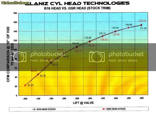

    the GSR head flows just about the same, the only bad thing about the gsr is the stock intake manifold. Swapping heads for a b16?? why? just use a skunk 2 intake manifold or a Blox intake manifold.

  7. phunky.buddha
    28,539
    262
    Dallas / Fort Worth, TX
    Yay! Thanks for finding the graphic.
