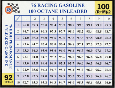

Another thing i was wondering, I have access to 100 octane but it is $4.50 a gallon would it actually help if I were to mix say 1 or 2 gallons of 100 in with every fill up or do you think the mix between the two would just kind of dilute the 100 enough to not really make a difference.
If you blend 92 and 100, this chart shows how diluting the 92 and 100 will increase the average octane.
There are other charts out there for 90, 91, 92, 93 and so on octane, but it's pretty easy to calculate by hand.
