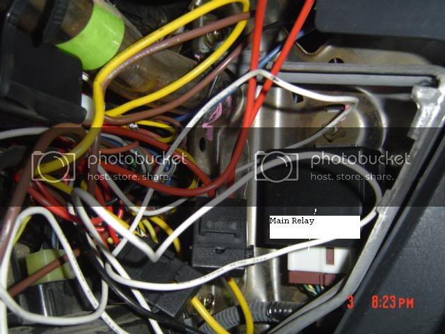

WTF, now I can't find my main relay. even took down the panel under the steering column and can't see it. Where exactly is the main relay in a 2000 civic si?
I guess nobody knows, oh well I finally found it, I took pics to help future searchers I'll post them up tomorrow.

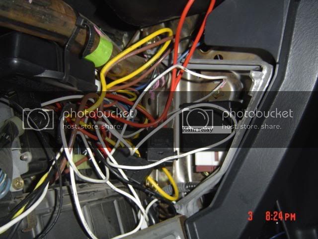

To get to main relay on 2000 civic si, you need to reomve the panel on the far right side of the dash
then drop you glove box look inside where the glove box was to the right and you will see the main relay (don't mind all the wires you see in my pics, those are to the relays for my door poppers so yours won't look exactly like mine)

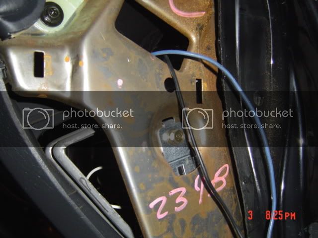

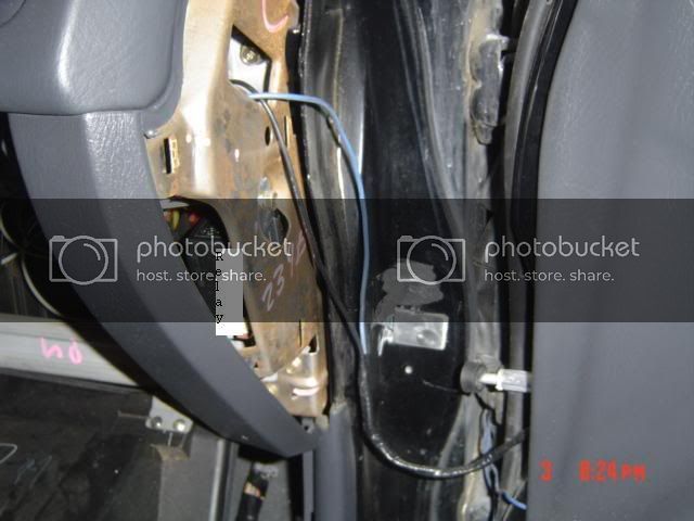

you can also see it from outside
It's being held by a 10mm bolt
remove the bolt remove the relay from the bracket and remove the connector, install in reverse.
