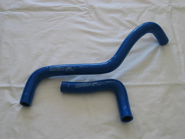

    so i'm getting ready to start buying things for my turbo kit...
    the first thing i need is a half size radiator and new hoses (for looks)
    so i saw this for a delsol
    for $105
    then i saw these for a 88-91 civic
    for $52
    these are not the best products but they do the trick.. are they what i need?
    my question is what hoses do i need to fit the half sized radiator....i know i have to slant it towards the engine...but i know nothing about the hoses...
    right now i have a 90 teg rad and hoses

    you need the hoses that go with the radiator. (the year civic or del sol it came from)

    Upper Radiator Hose: 92 GSR, trim to fit
    Lower Radiator Hose: 90 Integra, trim to fit

    i already have those..i just want red hoses and the only sell them in pairs for specific aplications

    go to a autoparts store and check the difference in the lower radiator hose to see if there different and if not the but the matching set for the gsr

    actualy he can use the civic hose in his swapped car. I am using teh civic lower and teg upper in my b16 crx. I had to trim teh teg upper about 2 inches to make it not kink.
