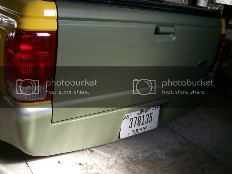

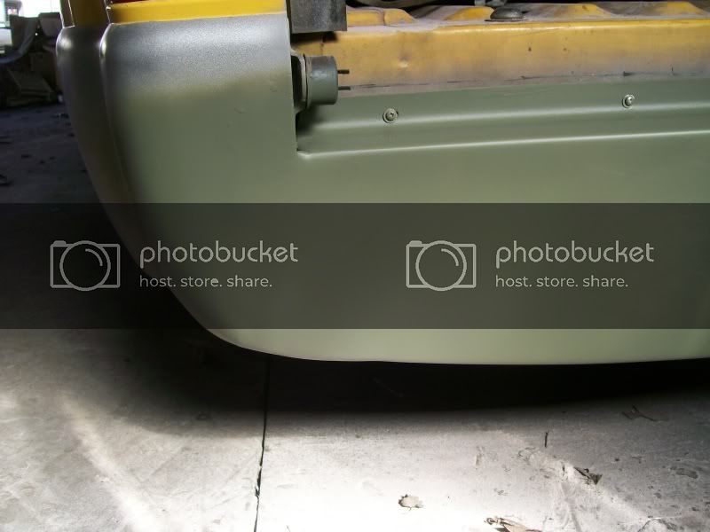

    **UPDATE**
    alright i got it done!!! shes molded in. pics and info below on everything.
    *note* in no way at all am i one that does body work so if i didnt do something right or too well, this was my first time doing this.
    first i sanded down the area where i was gonna apply my fiberglass and then added some fiberglass matt down soaked in resin/hardner mix:
    after letting it dry for a day (it was a little cool thats why it took so long), i added some body filler and put it on as smooth as possible so it wouldnt be such a pain to sand:
    after letting the body filler cure for awhile, i sanded it down nice and smooth:
    i had to add some extra body filler in some places to get it too look right.
    after sanding the body filler down, and cleaning the dust off, i primered it real nice:
    and heres what it looks like with the tailgate on and truck aired down:
    i still have a few spots i need to redo, but for the most part, its done!! thanks for looking and any and all feedback is welcome :)
