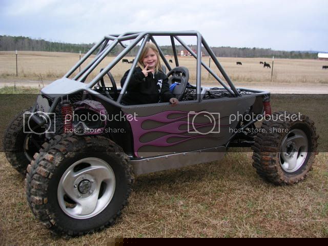

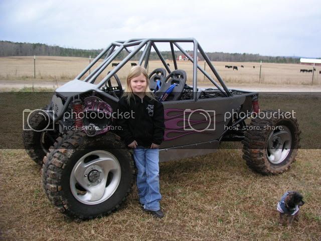

Well my brother has decided to hold off on his new bugy for a while until he's better financially set. However, my buddy decided to build a mini-buggy for his daughter for Christmas using a Civic drive train. Here are some pics of it:
He hasn't locked the diffs yet because he wants her to learn how to wheel without them to begin with. (She's 7 years old.) It has Samurai axles and 31" Super Swamper Boggers, 1-link front and rear. :)

^^Awesome lil buggy.
Hope his 7 year old is somewhat responsible. Lil bastard is probably capable of 120+mph.
