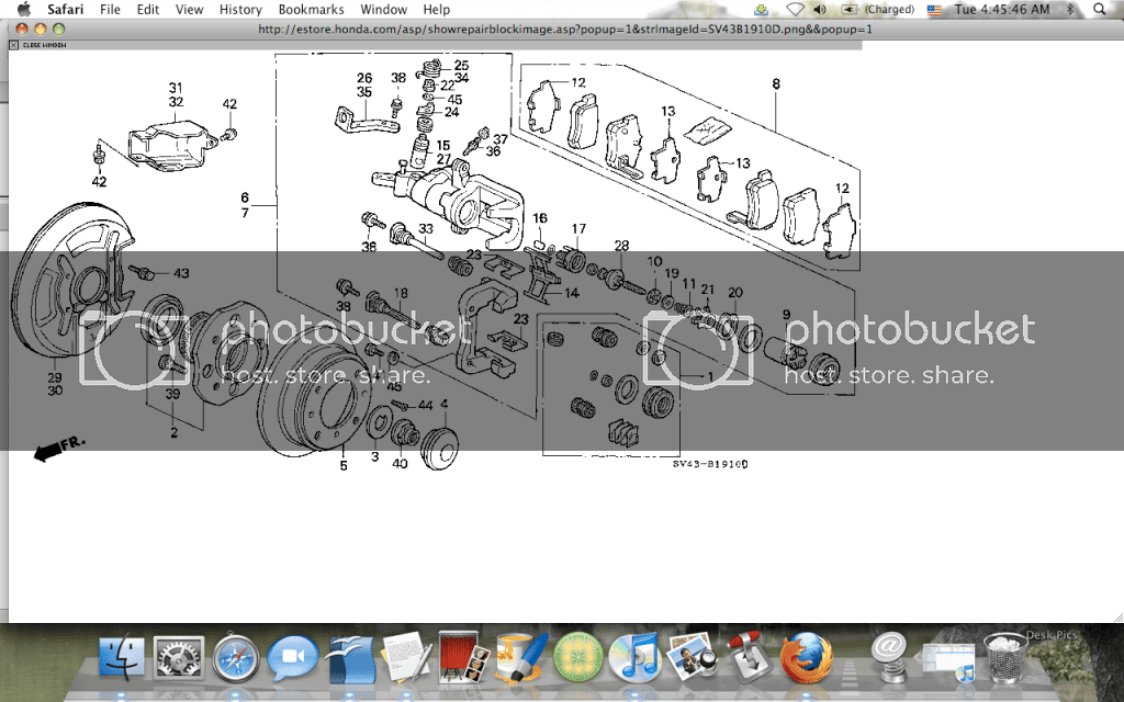

  5. f22b1 coupe
    f22b1 coupe Junior Member
    346
    14
    Dec 30, 2005
    Indiana
    Those pins are number 33 and 18 in the picture- you definitely want those moving freely or you will end up with severely uneven brake wear in the rear and possibly warped rotors or brakes that aren't squeezing at all. They are overlooked on nearly every accord I get ahold of- hell, preludes too.
  6. flyingsolo
    flyingsolo New Member
    38
    Apr 17, 2010
    Ocala, FL
    Ok awesome. Thanks for the help and the diagram. That will help a lot. I don't have one now, but would you recommend getting a floor jack instead of using the scissors jack thats in the car?
