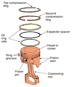

    Were the rings clocked correctly when it was rebuilt? One every motor I've seen that had valve sealing issues, the car smoked a bunch during cold starts due to oil seeping down.

    You mean the ring gaps were set apart from each other equally? I would assume so coming from one of the best machine shops from town haha.

    by clocked, the ring gaps are not seated on top of each other, ie. staggered.

    That's what I was trying to explain haha, even I knew that, I'm sure it's standard knowledge for an engine builder
