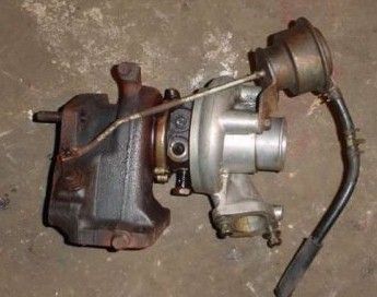

    it is a td04 13g, from a first gen eagle talon tsi. my friend told me it is a 13g, but it says td04 on the housing. the car was in a junkyard and my friends and i pulled it off. it has no shaft play whatsoever. i was also thinking i should do a mini me swap depending on how much it will cost.

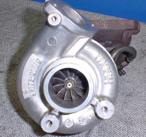

    TD05h aka 14b turbocharger from a DSM 1g Manual
    The DSM 1g Automatic Turbo. Known as the TD04. The TD04 is basically shaped the same as the 14b in most ways. The exhaust wheel and compressor are a bit smaller. This turbo boost's similar to the DSM T-25 turbo setup.
    You don't study that much do you? Did your friend tell you it was a 13g and you just believed him/her? I'd school your friend if I were you, giving you incorrect information and all :p .
    For information on how to make a DIY Homemade Turbokit, visit Homemade Turbo and spend a solid hour reading all the tech articles and turbo projects. You will have 90% of your questions answered by doing so.
    All you would really need to buy is an HF/CX/VX/[STD(best choice)] Manifold, DSM turbo, DSM BOV, DSM (Sidemount) IC if you want to be a sleeper, A few vacuum lines, hoses for coolant and oil, fittings to tap into your oil pan and manifold, err some fittings for engine management stoof (I forgot what), piping for Intercooler Pipes (Charge Piping), gaskets for your to-be-fabbed turbo adapter, and a custom downpipe you can have made at a good exhaust shop. You can make your own Turbo Adapter out of mild steel and some machining. Since you are going to be using the 14b turbocharger, you will only be able to tap 3 bolt holes on the turbo side. It is advised that you weld the turbo to the adapter plate (with gasket) and weld the bolts on the turbo side, once after all is test fitted.
