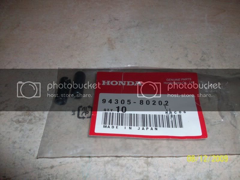

    thanx,and also i know that the shift linkage has a pin right how do i get that out?

    benson1121 New Member
    54
    Aug 12, 2009
    Atlanta
    i like that! thank you so much. so simple. usually have the right tools .... last time we didnt, ended up having to buy a new bitch pin...ruined the old one lol.
  9. D15Beater
    D15Beater HNFTuning
    541
    8
    Jun 8, 2007
    Concord N.C.
    M6 threaded bolt and a hammer. Use the wrong size punch or screwdriver and youll spread it, making more work for yourself.
    Called a bitch pin for a reason...
    You can buy them from majestic Honda or Delray Acura by the pack, qty-10 or one at a time. #94305-80202
