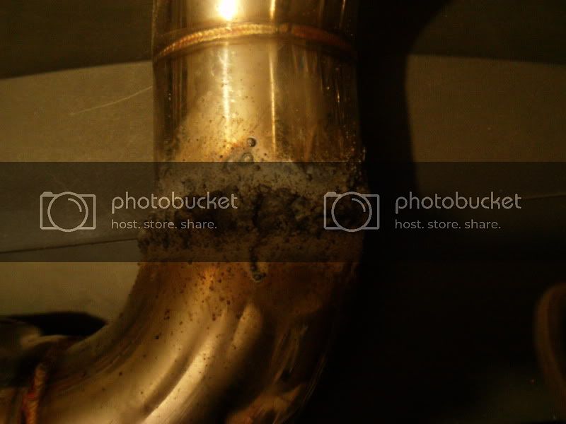

grind the welds down and they wont look so ugly..
but lets see a pic of them,,hell as long as they hold the gases then fuck it
It looks like the welder puked all over it. :( I did it w/o a argon tank, all electric is poo. I will be upgrading someday when it's finally all put together.
holy dick beans, that looks like some kind of horrible infection : |
^what he said
lol thats why you should have practiced on an unneeded piece..so you could get the settings right as well as getting used to what your welding
