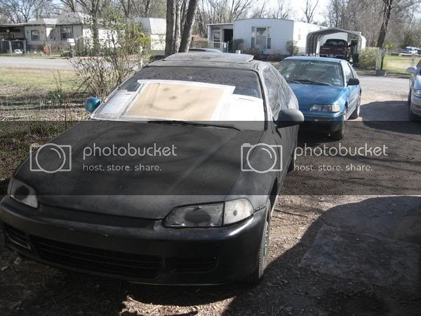

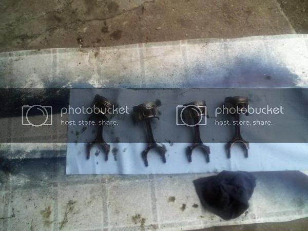

I bought my old civic off of a friend after 250k miles and a spun bearing.

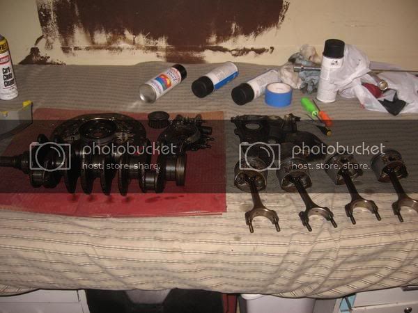

Don't judge me, my friends got bored with the spray paint.

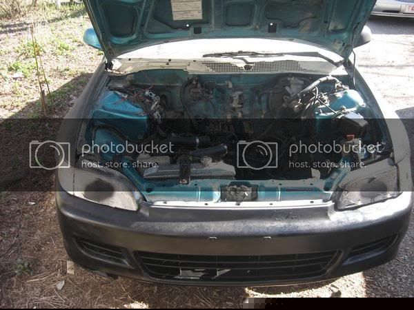

The Bay

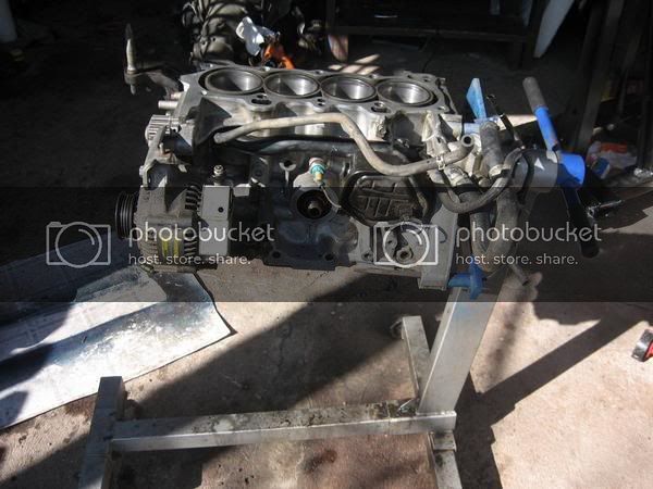

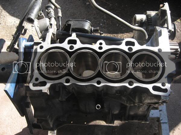

Honed the Cylinders. I am a clean Freak when it comes to my engines...

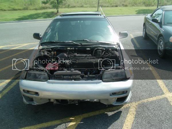

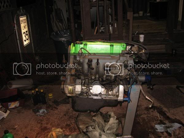

Oh yah, this is the D16a6 in my DD Crx as of now, Once it's out I will tuck all the hoses, lines and wires...

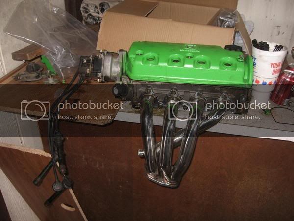

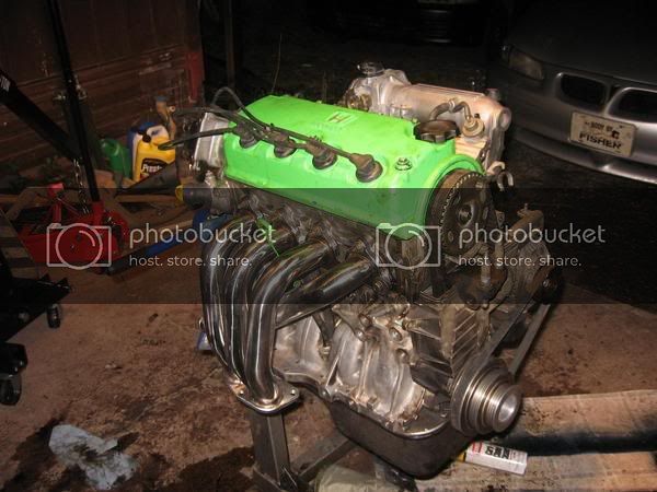

I have seen the Ad in a few magazines for the Hondata Gaskets and was curious so I may try one. I am needing help in the head department, I can't decide which would be the best to swap using my obd0 harness and the y8 block. z6, a6 or y8? I am guessing the a6 would not be best for turbo applications. I may take it to get a mild port & polish, maybe a valve job at a shop a few miles away. Springs, Retainers, Valves, etc... It will be easy to find a head of my choosing at a salvage near by considering everyone here shells out all their cash on farm trucks and tractors. Thanks in advance...
if your staying obdo then get the y8 head..the obd0 dizzy will bolt up with no modifications...but the obd0 dizzy lines up poorly on the z6 head..and plus 1 for the port and polish..i port and polished my head at my own house

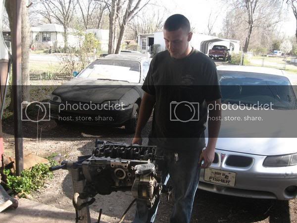

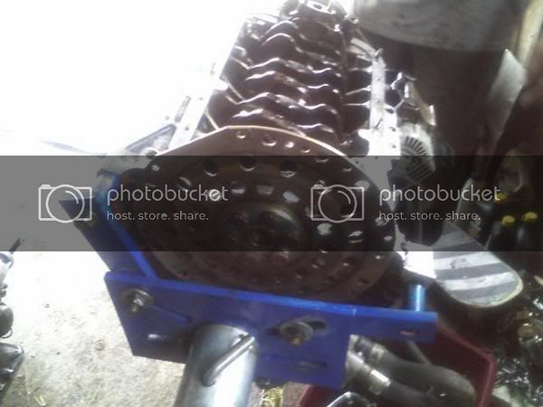

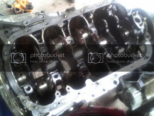

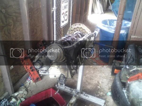

I have heard the a6 oil pan is easier to tap into for the Turbo oil line but I may just use the y8 oil pan since it's already off. I polished up the bottom of the block where the crank sits last night and I will have more pictures up soon. Any other suggestions on this build? I am having fun with the parts list right now.

yea you will need to read the bearings on the bottom of the block and get the correct OEM bearings
OEM Recommended I am guessing? The Rod Bearings & Mains may come with the rods but I can auto zone some oem's. Still looking for a obd0 with a y8 thread somewhere.
right but..youd be better of atleast getting an obd0 b16 ecu..then chip it for your specs..
The B16 OBD0's are equipped with vtec, I will see if I can find one so it will be a little bit easier. I have been considering a p28 obd1 conversion but dunno if I want to deal with it yet. I know it would pay off in the long run. I have been trying to scrub the block clean every night to no avail, the oil was baked on the inside of this thing. I can tell I am making some progress though. Using B-12 Chemtool, it smells like paint thinner in a spray can.
aircraft stripper might work better..also for bearings go to the dealership..dont get autozone bearings..also the obd1 conversion would be better
Where can I find some aircraft stripper? Dealership it is and I may convert to obd1 as soon as it's up and running. Thanks Injen, tons of helpful info as always.
