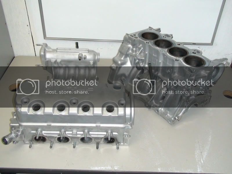

I know it's a bit ludicrous but that is what I want, This is an image of a D16z6.
lol no,,that stuff has a mild polish done to it..
but it will make it pretty clean i think...you can also try purple power and a pressure washer..
i know on my DA,i scraped every spec of grease of the block,id scrape,pressurewash,scrape,pressurewash..this was over like a course of a week..shit was clean

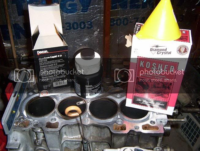

Haha, Damn. Well, I have until next summer when Import Face Off and Street Warriorz comes to Tulsa,Ok but I am hoping to drop it in before that so I can Test & Tune. I am thinking about a Block Guard or Sleeves but I ran into someone saying I should use the devcon and Epsom salt approach?
Devcon filled D16 block. Block is filled past the water pump port with sugar, then filled with devcon f-2 liquid aluminum. Salt is washed out and holes are drilled in the devcon to allow water to pass down.
The supposed benefits over a block guard are that it supports both the top and middle of the cylinders rather than just the top. A member on HomeMade Turbo said that his machinist did a bore job on a devcon filled block and said that it eliminated any cylinder walk when he bored. Any Ideas? I would like to buy the Darton Wet Sleeves but the 500$ is going to hurt.
Okay, fuck that. Everyone B knows of who went the Devcon route blew up. Damnit, why do all the good parts have to cost more? Sarcastic question and hey what the fuck is he doing up at 4AM?

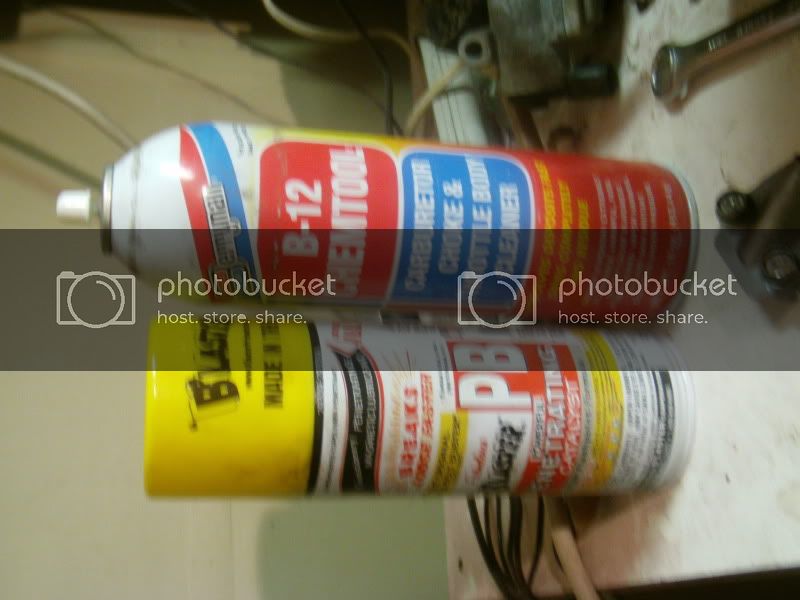

Thanks for the link adding more crazy shit I am going to try in this epic thread. What if I wrapped it in plastic and let it set outside under the porch? I am almost finished with cleaning the block, just picked some pb blaster up from wal-mart.

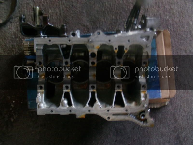

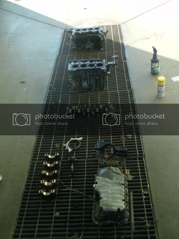

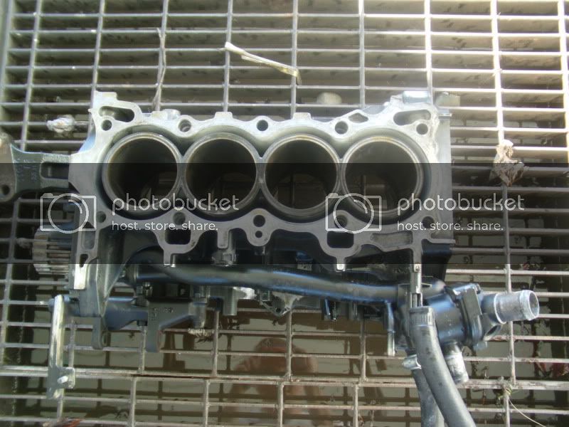

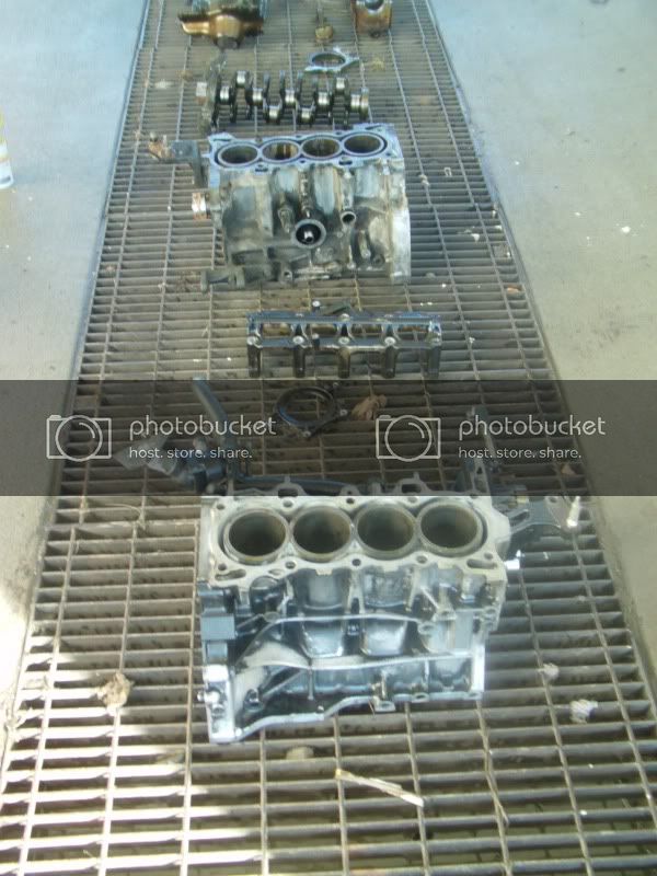

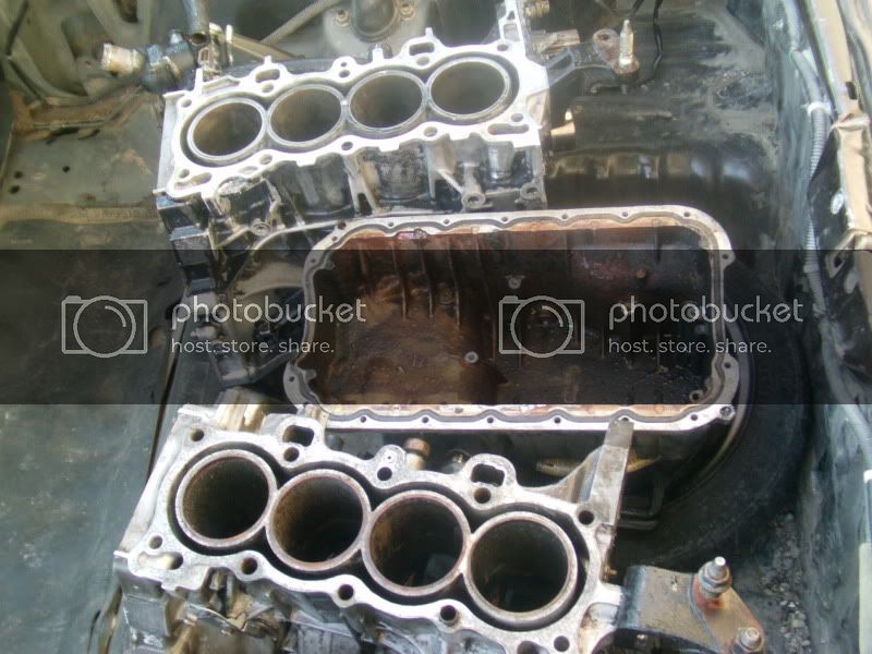

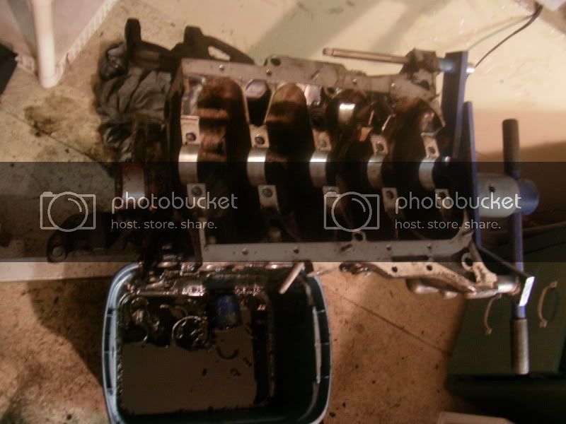

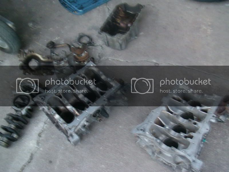

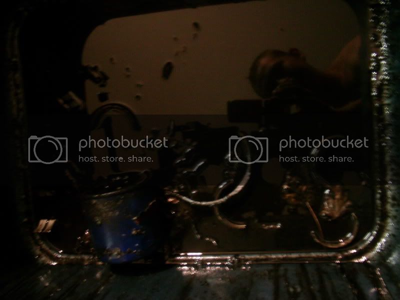

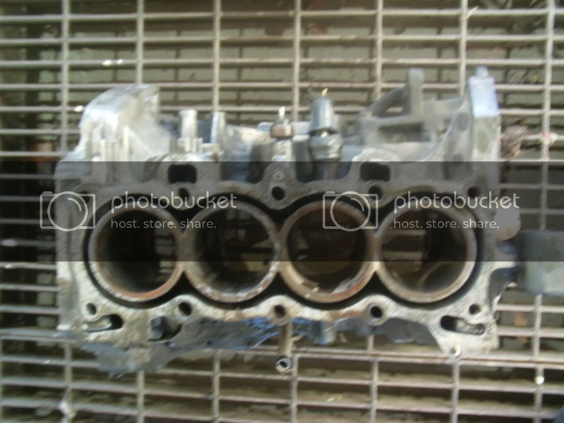

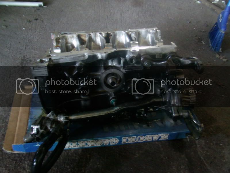

Well me & my homie spent an hour trying to pull one of the Pistons & Rod out of his d15 and he finally got the idea to hone the cylinder out and try again. It worked and we hauled all our shit to the car wash since we don't have a pressure washer. It got most of the oil and grease off and his looks pretty clean but I still have a shit ton of black paint on mine in places. Here are the latest pics!
His D15B2:
After we took it apart:
Tools Used:
Block:
Side:
Car Wash!:
D15:
D16:

Airing it all out:
that crank is probably gong to be junk now..and the oil pump/pickup..
lol all i said was to do the block
