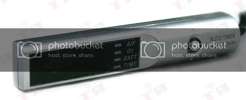

Would one of these suffice? 35 buck eBay special, Battery, o2, Air/Fuel, Turbo Timer:
I have one of these in my car. It took me about 20-30min to run the wires. It worked fine for a few weeks, then out of the blue it stopped keeping the car runnin when the key is out of the ignition. The timer counts down.. but the car is already off..
weird, so it just shuts off when you take the key out and the timer keeps going. I will try it and hope for the best. How does it read the Air/Fuel? Does it give an accurate reading like numbers for example or does it show bars to measure it? Glad to hear that it was easy to install. The easier, the better.
