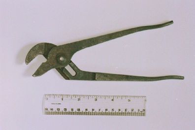

    Channel locks, they are designed to grip harder when you start to turn, the harder you turn, the harder they grip, check it out

    I feel like I know what channel locks are but for some reason I can't put the tool with the name... is that like a pipe wrench?
