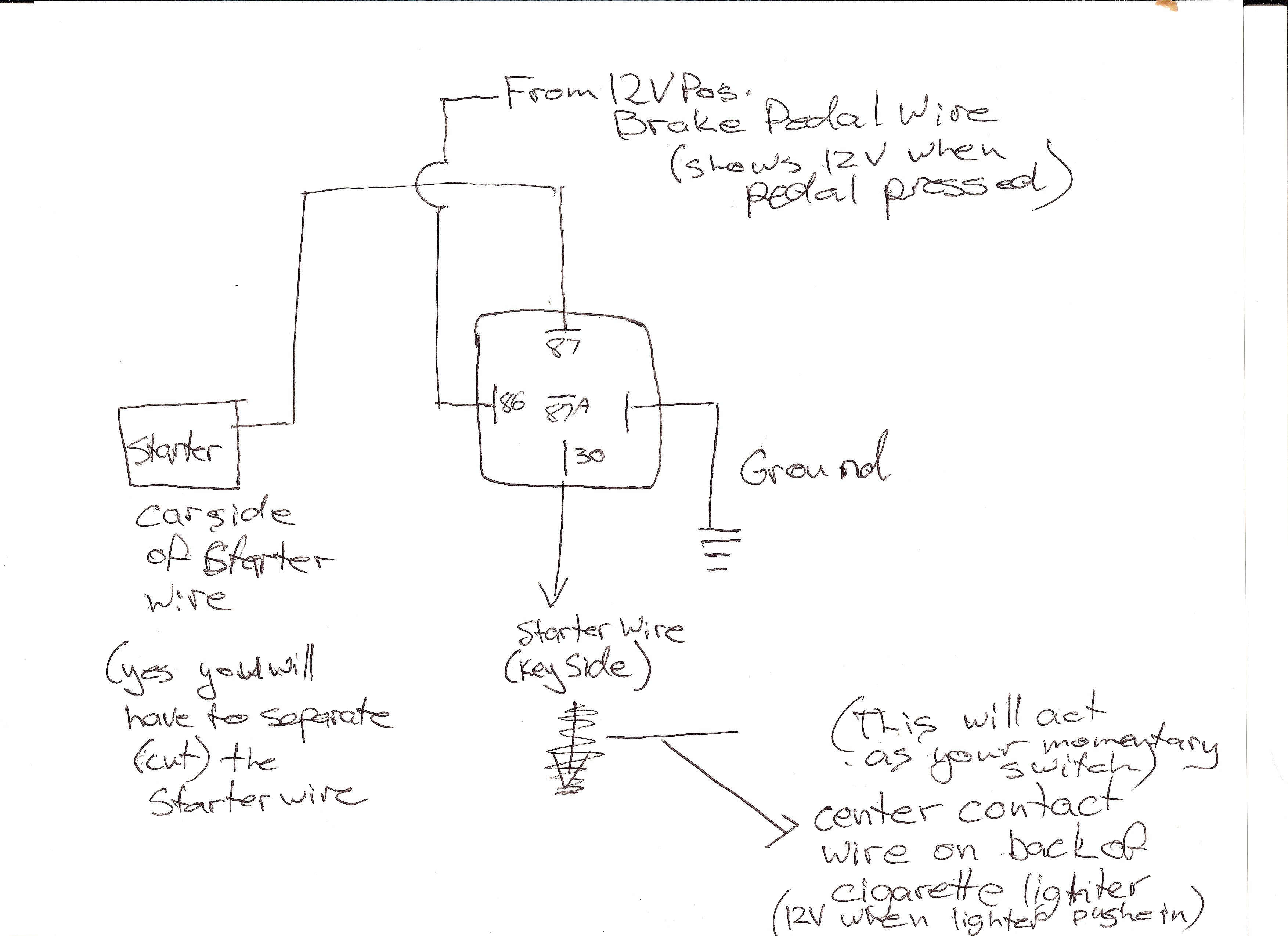

    .... if you use an SPDT relay and fuse you power wire, then it's entirley possible to have it so that it doesn't operate once the car is started. ....... Lemme consult my Bosch relay manual.

    Why not just wire it up so that you use the cigarette lighter as the push button. Find the part on the lighter that keeps it held down and remove that. This way, it's totally stealth, and once the car is started, you can just pull out the lighter;)

    Yup, yer right. it CAN be done easily. Unfortunately, if you DON"T use a Bosch SPDT relay and put a fuse in line with the power, your circuit will have no protection. I don't know about the rest of you but I'm not overly fond of electrical fires in OR out of the car. Fusing is a MUST. It's the only thing stopping an overloaded or shorting wire from LITERALLY(and I MEAN this) BURNING UP!!!!!
    A relay is cheap. A relay ALSO serves as circuit protection. Every auto parts store has them. Don't be a CHEAP jackass. Go buy one, do it RIGHT, or just pay someone else to do it. Losing your ride in an electrical fire is not only DUMB, but PREVENTABLE. I never seem to be able to stress this point enough.
    PROTECT YOUR WIRING!!!!!!!!!! "FUSE IT OR LOSE IT":rolleyes:
