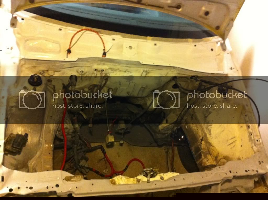

    I have everything pulled out of the engine bay on my 86 crx hf. Right now I am working on rebuilding the engine but I want to get the bay cleaned up before I put the engine back in.
    I already painted the frames under the fenders with spray cans as a test before I do the whole engine bay. It came out pretty decent, but it doesnt have a clearcoat so I am worried that it will get ruined very quickly. I'm not even sure how spray paint would even hold up. Has anyone done this? Should I continue with the spray cans or should I take it to a shop and have it sprayed correctly?

    What exactly should I do to prep the old paint? I was planning on just sanding all the old grease and grime off the old paint and wiping it down with a tack cloth before I paint. Should that be good enough?
    I have most of it done except some on the drovers side. This is what it looks like now.

    I do engine bays all the time and depending on how much the customer wants to pay, I decide on whether to use spray paint or use dupont paints and primers. This is what i do; degrease the engine bay first with a good cleaner ( i use Purple Stuff, you can find it at any auto parts store ) then i sand it with a scotch brite pad (the red one) or you can use 400 grit wet or dry sandpaper and sand the entire bay, if you can i would buy a can of bulldog adhesive promoter or any adhesive promoter will work, i do this because if you miss a spot during sanding the paint wont stick very well to a shiny spot. If your going to rattle can it, make sure that you select a paint that is chemical resistant since there will be brake fluid, oil, gas, etc.
