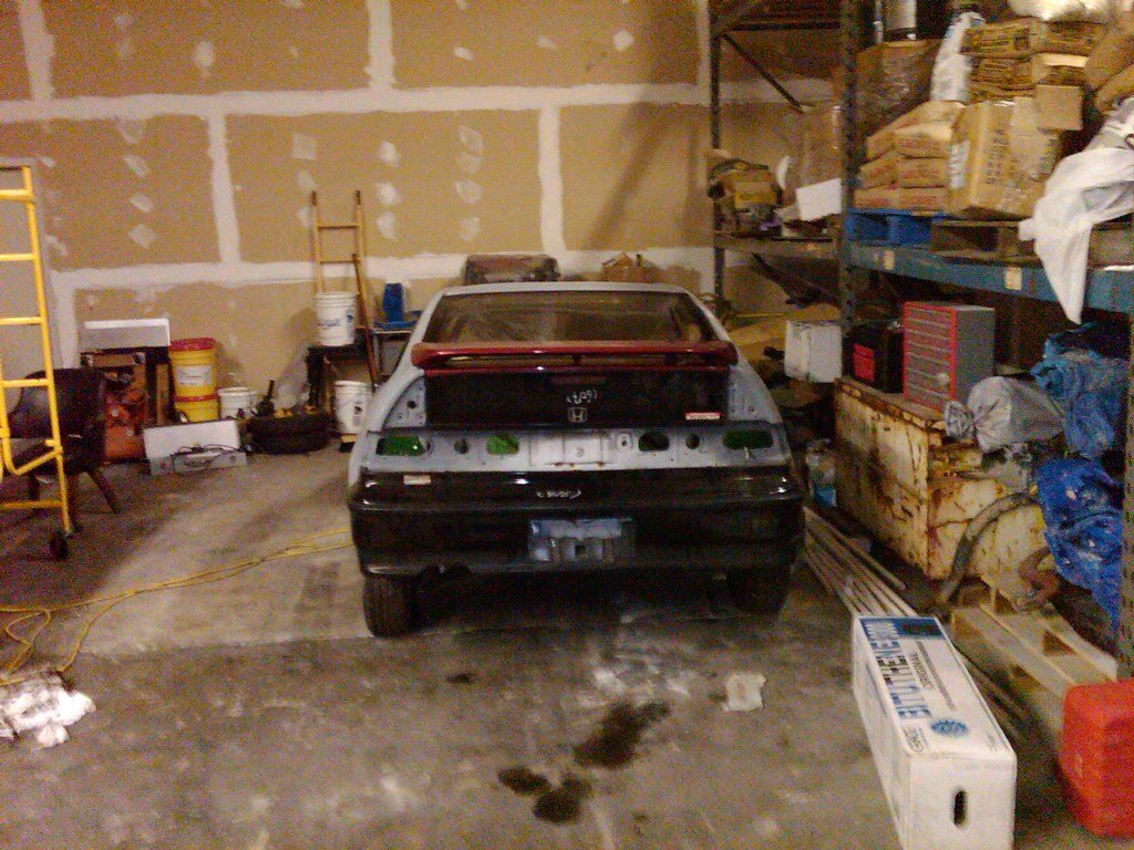

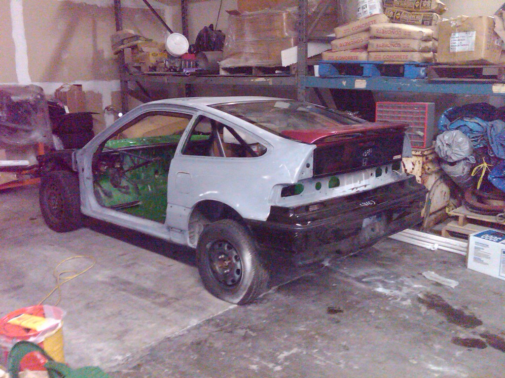

    my buddy gave me his old shell. him and i are bringing it back to life. more to come.
    the shell
    engine bay painted championship white. i may just do this color for the white on the body because it looks pretty good and i dont feel like screwing with a 3 stage paint.

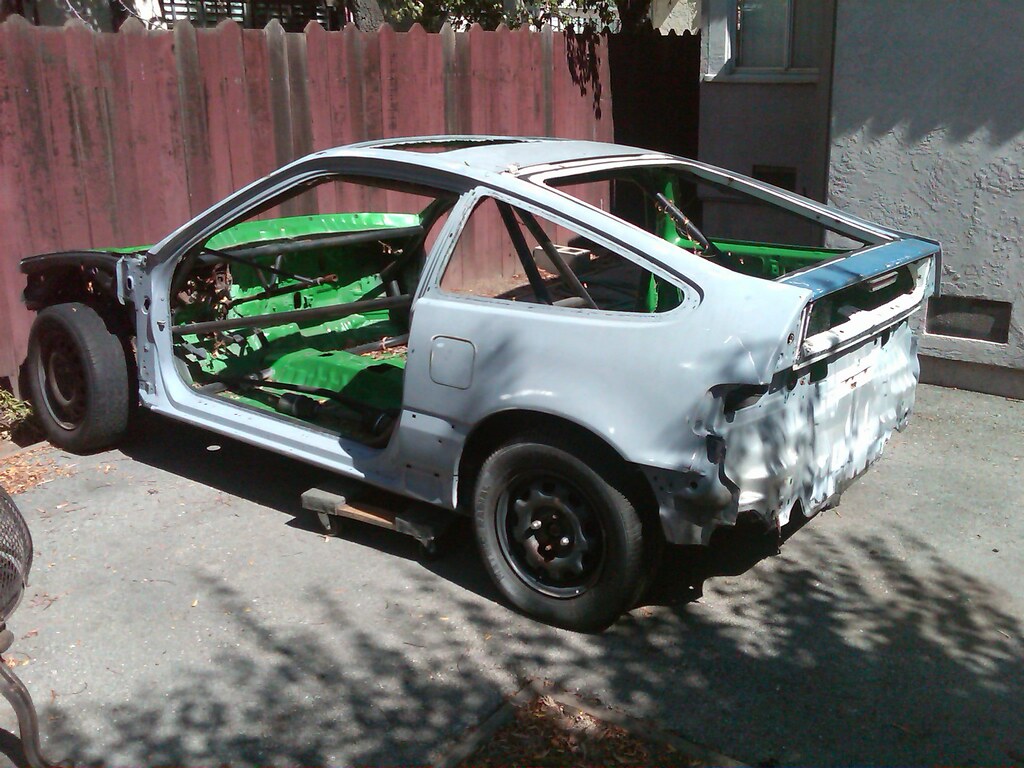

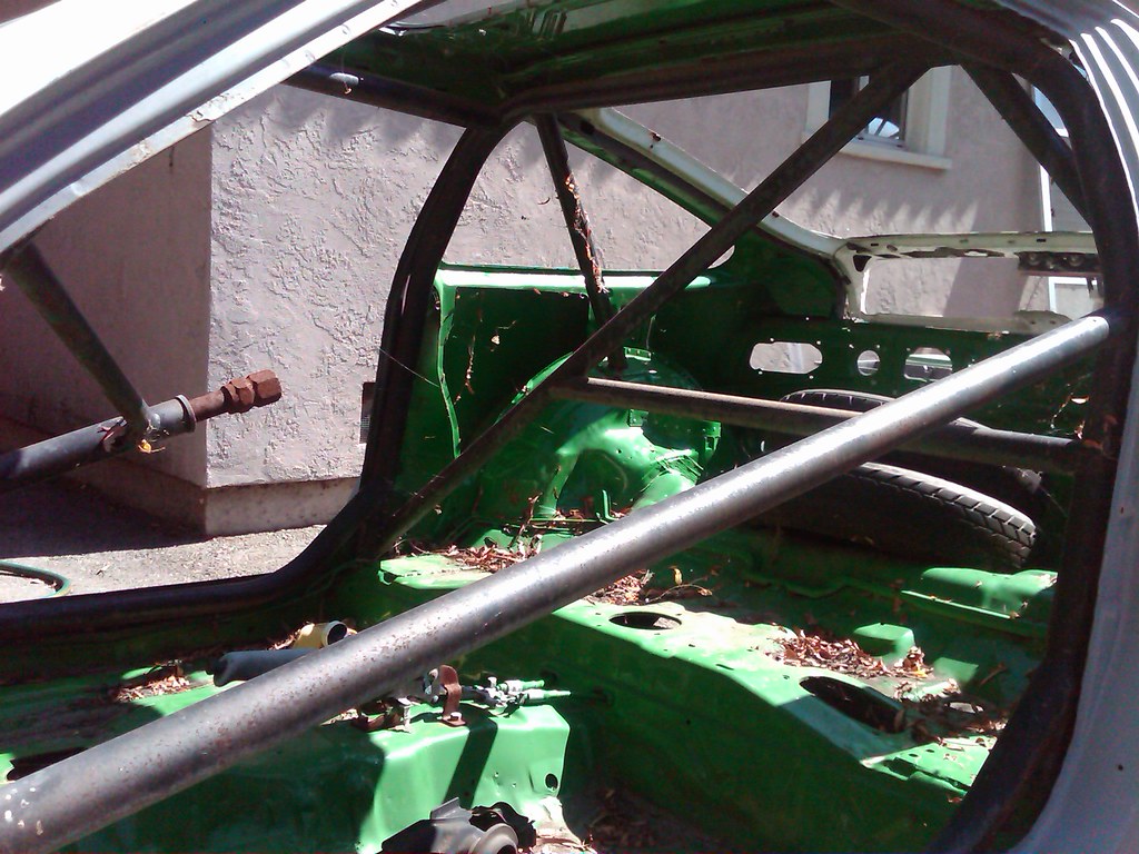

    cage is all wrapped up and the inside is almost ready for paint. probably a good 3-4 more hours of prep

  2. INJEN78
    INJEN78 HS LEGEND
    9,187
    121
    Oct 1, 2007
    OHIO
    why is there a front hoop welded on that car??
    what are the pnas other than the ctr motor?

  3. kelsodeez
    kelsodeez New Member
    833
    33
    Sep 24, 2009
    bay area, CA
    there was a front loop welded as part of the cage because this car used to have an h22 running low 9's. i am now making it an endurance car.

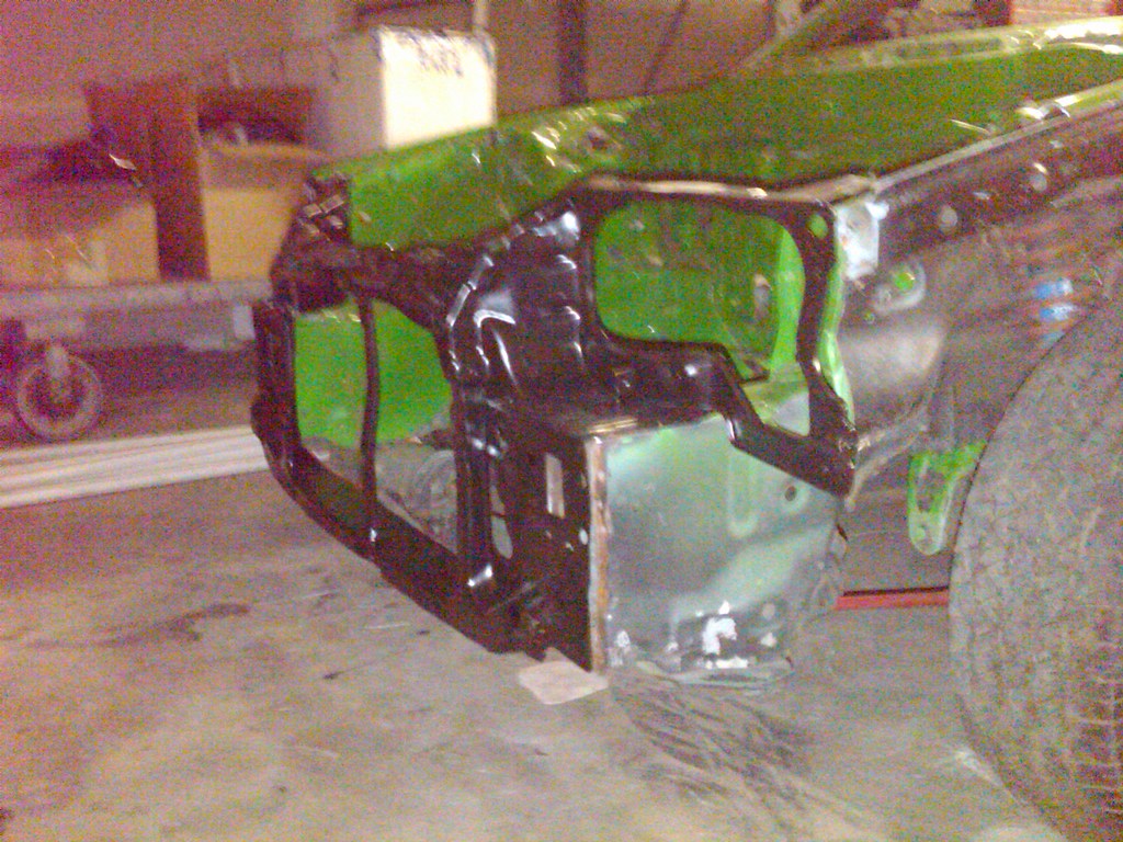

  10. kelsodeez
    833
    33
    Sep 24, 2009
    bay area, CA
    yea dude. im pretty sure the power from that engine warped the frame a little because after i cut off the loop and tried to bolt up the radiator support, i had to use the porter frame puller to line up all the top mounting holes. i hope it doesnt effect handling too bad but its nothing a few extra points in the roll cage wont fix :D

  12. kelsodeez
    833
    33
    Sep 24, 2009
    bay area, CA
    the drivers side frame rail holes were off about a quarter inch but the upper mount on the wall where the fender goes was off about a whole inch. the frame rail is straight now but i just need to tweak the top mount now.

  14. kelsodeez
    833
    33
    Sep 24, 2009
    bay area, CA
    well, to fit the alternator to the H22, the drivers side frame rail has to be hammered in a little bit. i attribute the condition its in to that. id probably be better off getting a different shell and using that, but this shell was given to me, its a clean title 88 si which is becoming more rare by the day. the build continues!

  16. kelsodeez
    833
    33
    Sep 24, 2009
    bay area, CA
    yup and now its pretty impossible to pound it back out at this point. oh well. the frame will be plenty stiff the way the roll cage is and the few additions i will be adding to it.
