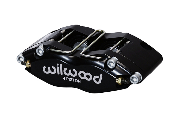

yea, i ended up just refinishing them and getting all new bushings. next on the list of things to do is get an ecu, figure out how to get the spindle bearings out to replace them, and start gathering front brake stuff. heres what i have in mind for the front brakes.....
wilwood dynapro 4 piston billet calipers.
Wilwood is always a good choice. This thread just reminds me that I need to get another job. :(
