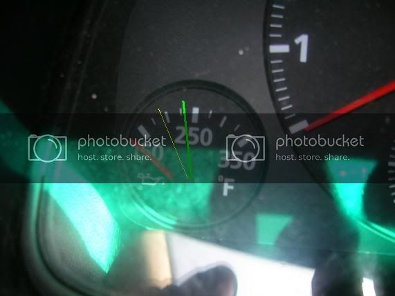

    The one thing I noticed yesterday that leads me to believe it really is the oil pump is because the oil is sporadically hotter then normal. Normally it's stays around 180*, every now and then it'll shoot up to 220* or so.
    I guess it's worth a shot to replace it but I do need to check it out first and find out where the noise is comming from first.

    you haev an oil temp guage? 180 and 220 sound like water tempt to me...
  11. 92civicb18b1
    92civicb18b1 The Trisexual
    8,859
    18
    Oct 1, 2003
    Yep, I have the stock oil temp and obviously a water temp...
    It's probably closer to 200 rather then 180, I just rounded it off.
    yellow is the "normal", it's not a drastic change but enough to bother me.

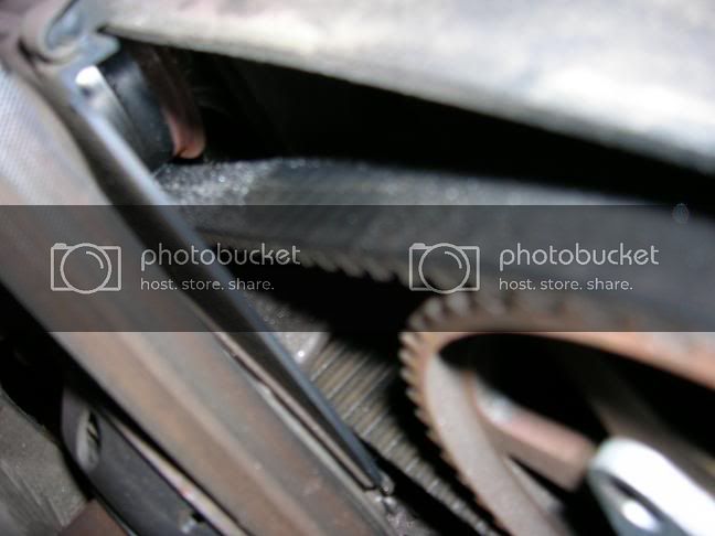

    Isn't this interesting...
    I always liked metal shavings, I also love a rod knock in cylinder 6.
