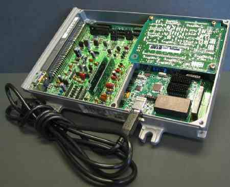

Depend son your car. You will need to score a usdm 99-00 civic Si or 96-01 integra GSR ecu for emissions purposes, as it's obd2. you should be able to limp around with no issues (keep it under 3500 rpms). provided you also put in the stock injectors (as you'll liekly need larger injectors if you're going high compression)
s300 requires an obd1 ecu and a jumper harness.
it really depends on what car.
96-98 use a different plug con fig than 99-01. (obd2a vs obd2b)
no, it's an add-on to a factory ecu.
it adds the 'top' plate.
you'll likely need to buy a p28 and use an obd2b to obd1 conversion harness. the engine harness you should use what's in your car and add wires where necessary, unless you can find a 99-00 civic si harness (rare, big $$$)
