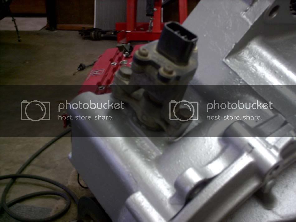

  6. eg6sir
    21,692
    yes.. its under the hood.. where else would the tranny be.. lol..
    here is a pic of it... if i had the teggie here i'd take a pic of it for you.. the woman has it
