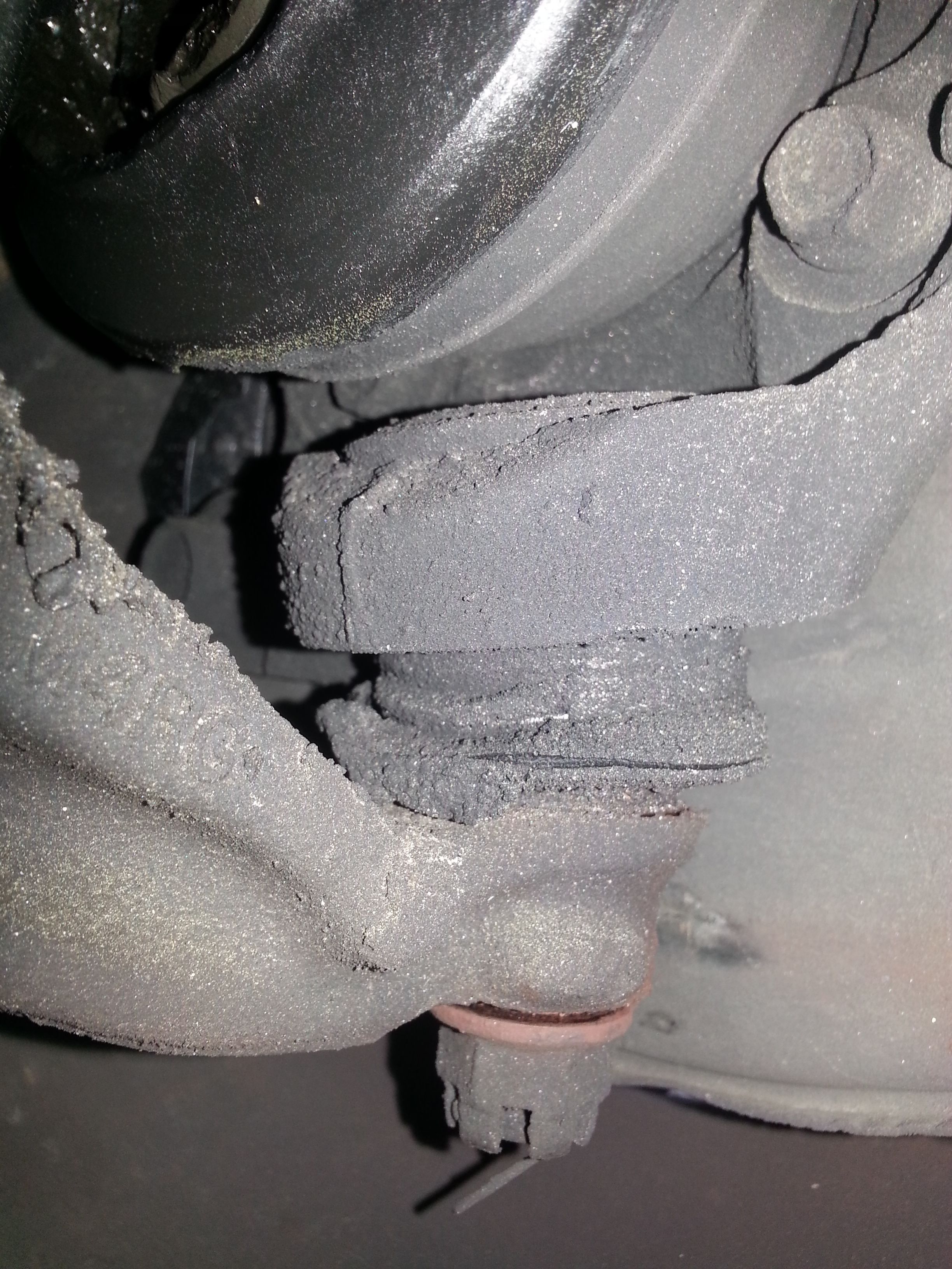

    Okay so I feel so damn stupid but I tightened down on the bar and end links. The left one wasn't tightened down all the way. (I drove it later and the problem is all fixed) I still gave everything a look over until I actually work on it and I noticed something. I'm STILL having issues with the right ball joint. I guess the vibration or whatever caused the nut to break the cotter pin and the nut was holding on by just a few threads. I' tightened it back on and I'll pick up some more cotter pins but Why is it happening.
    Thinking back to when I put the ball joint in I had no problems but when I put the assembly back in/on the lower control arm. I put the castle nut on and when it was in place on the bolt where you are suppose to put the cotter pin through. There is still a gap between the nut and the control arm. I didn't see a washer... do I need washer's or some sort of spacer? Would this gap and hitting holes cause enough force/damage to break the cotter pin?
  9. Ichigo1174
    Ichigo1174 Member
    335
    14
    Mar 5, 2010
    Florence, SC
    I saw this that I uploaded a while ago,This was first ball joint that broke on me in the the parking lot.... Maybe I do need washers... You only see the gap when the car is jacked up and its almost like you could fit a slightly smaller nut on there under the castle nut. I've also thought about the hole in the control arm is worn out but I'm not so sure. I'd need another control arm to compare it to.

  10. TurboMirage
    25,060
    922
    You should have atleast one washer on there. The cotter pins should never break. Either it was cracked or bad to weak to begin with.
