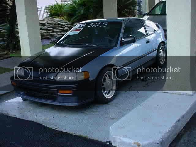

i had a high compression lsvtec. it was sick as hell in my crx. I just craved for more and eventually dissapointed me evertime i would think about what i "could have done"
damn i miss my cars :(
