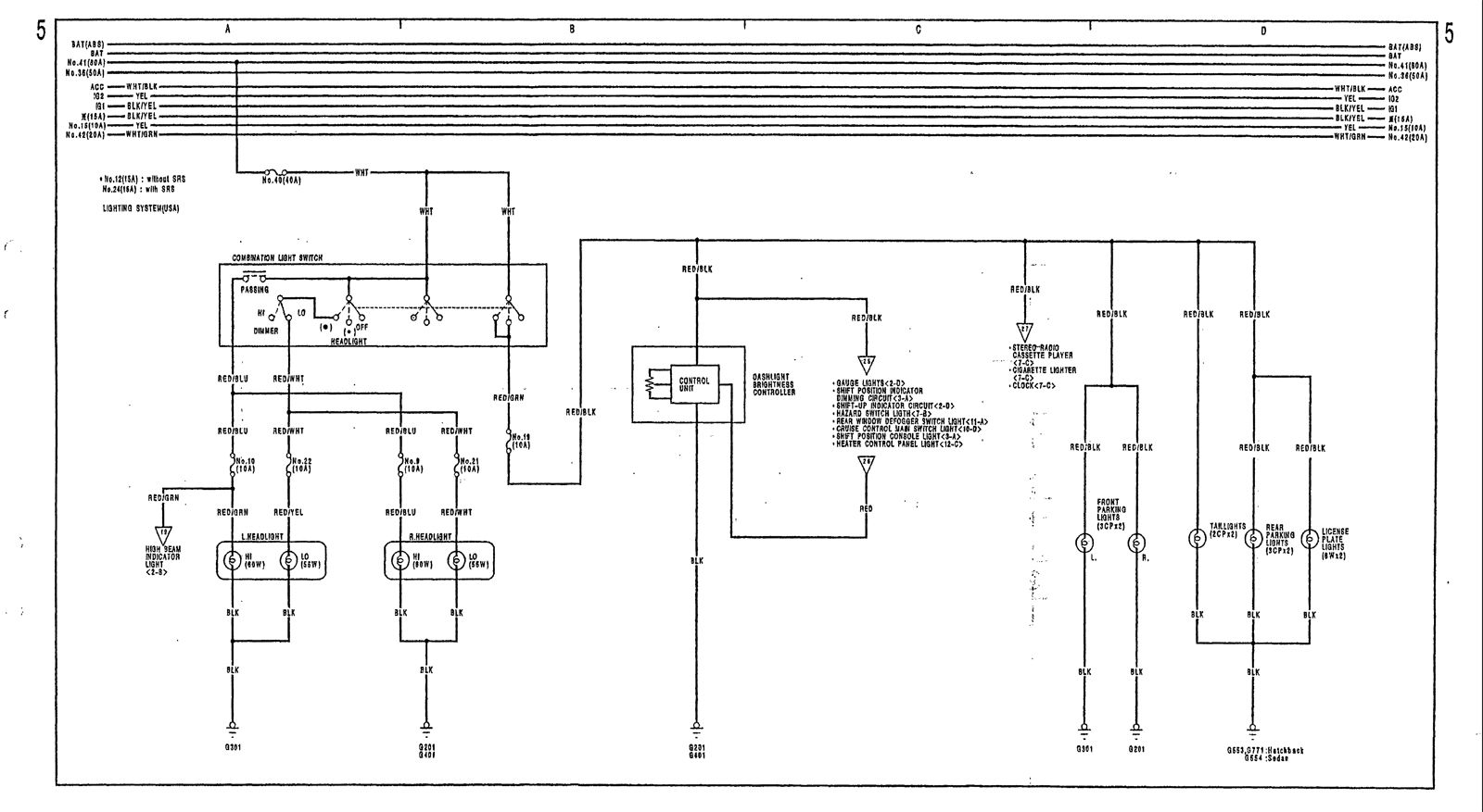

i have wiring diagrams i can give you, but it's up to you if you feel like you can do it. wiring is something it seems a lot of people are scared of, or cant grasp. you might want to take it to a shop if you dont feel like you can do it.
but yeah lmk if you want the diagrams or not.
ight :D
...wiring's my fav heh
this is a huge picture, and it's the USA model. lmk if ur in Canada, eh.
you want everything associated with fuse 19, and the red/black wire, etc.

it's something with the stereo or ( in that area ), if i pull the stereo out and disconnect it. the lights work fine. turned em off and on about 15 times with the car on and off never failed once. but as soon as i reconnect the stereo it blows 19 again
dash lights also incorporate part of the dimming circuit. check possibly the bulbs that illuminate the radio and such to make sure they're in all the way. not too sure without looking at it in front of me :\
