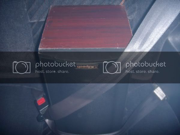

but for some reason the rear speakers just stopped working the other day, and i was too lazy to find out why so i just put some small floor speakers in the back hooked up to the amp.
