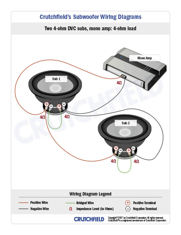

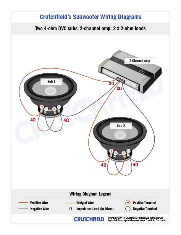

You probably have the subs wired wrong. If that's the case the amp protection will kick in and turn off the amp to prevent from damage.
Well the amp doesn't cut off, that's what I don't understand, in MY old system any type of overload would trip the safety, no fuses pop eihter.
I'll definitely check the wiring though.
Thanks
Try to wire it for a higher resistance. I've had this happen with Jensen, MTX, and Alpine amp. Everytime, it was because the subwoofer(s) were wired for low impedance and it was over-working the amp. The Jensen and Alpine would stay on, but still cut, while the light on the MTX would go out and come on.
