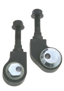

    Next up rear Camber kits these are what I had in mind. Are they overkill for what I'm looking to do?

    I think it's overkill. I have a set myself from another manufacturer (Ingalls) and I liked them a lot, but you can solve rear camber issues with a few washers and longer grade 8 bolts. Just get bolts that are half an inch longer than stock and get a few washers- each washer thickness added underneath the upper control arm mount gives you about a quarter degree of positive camber back. If you're not ultra picky about having your sides match to the closest tenth of a degree, you'll do fine with this $5 solution. When I used washers my rear camber ended up being within .2 degrees of each other in the rear.
