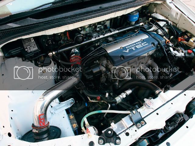

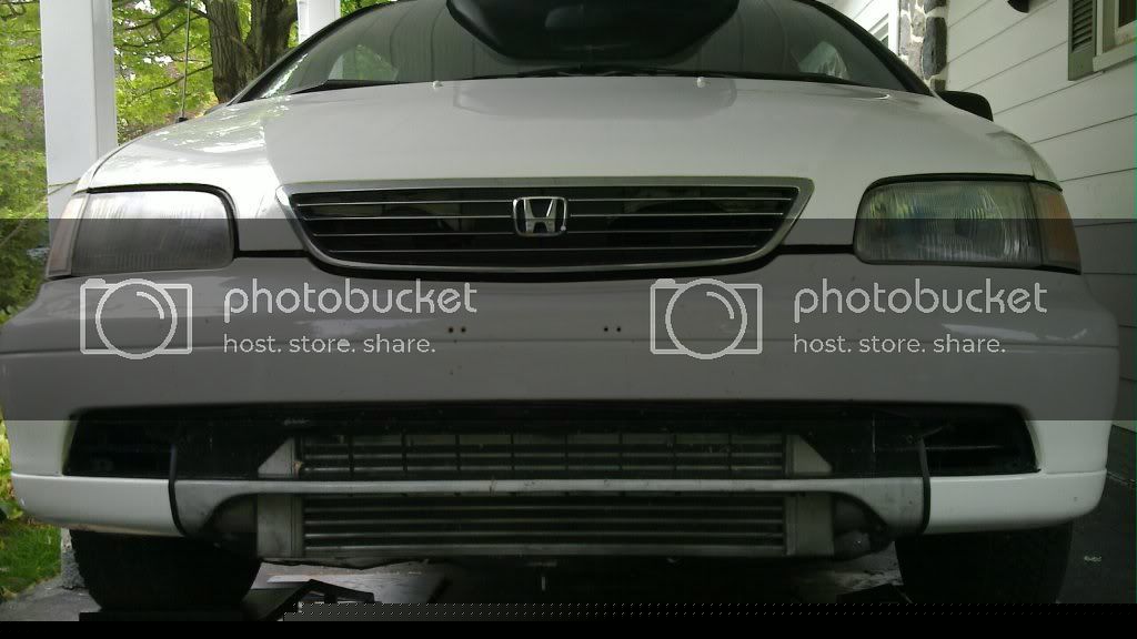

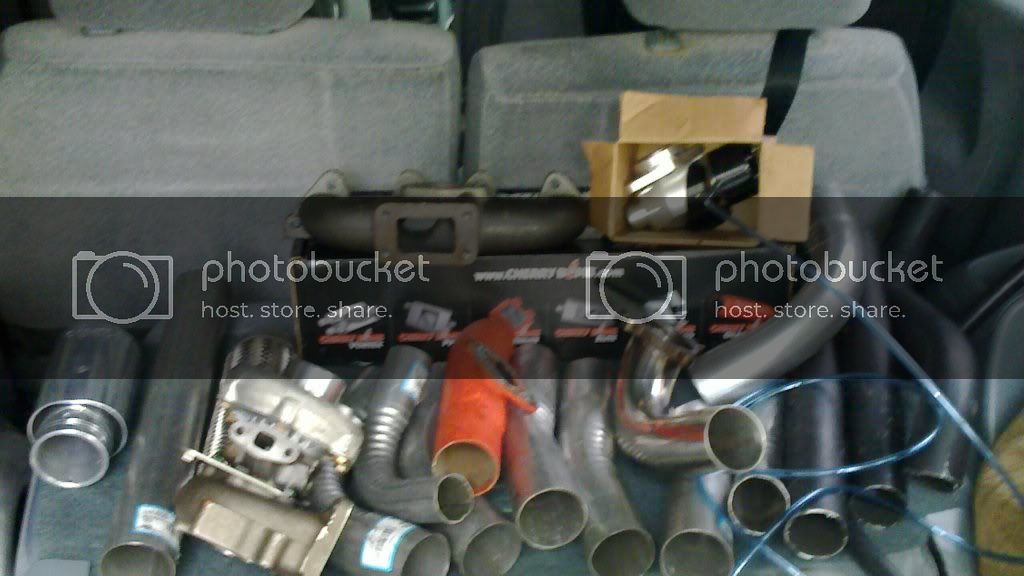

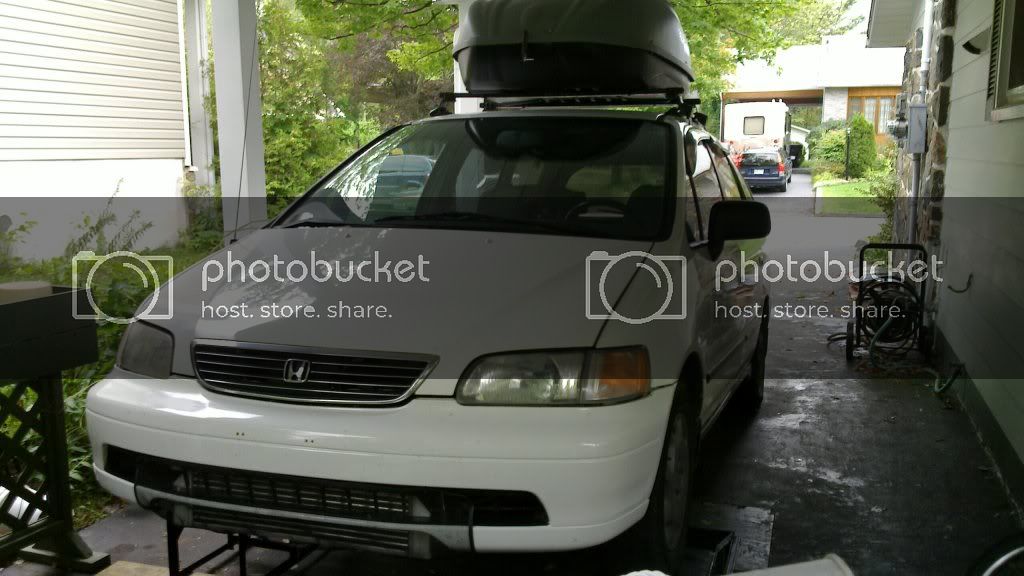

    I took the f22 turbo way.
    I finally decided to go with a T3 Garrett 50trim 48.ar hot/42ar cold with a log manifold. I'll be boosting 3 psi to start with and might go upto 5 psi since I'm on stock. btw, it's a jdm f22b 2.2L engine.
