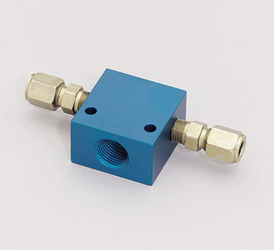

A little more bling than you are probably looking for, but an idea nonetheless.
Try looking on Aeroquip's site too, they might have what you are looking for.
