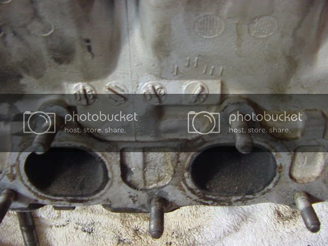

where exactly on the head is the date stamped
its on the lower left side of the front, right below the "B16A"
no that is where the engine code and serial number are stamped on the block. he's asking where the year it was cast is stamped on the head. and it's not actually stamped, it's part of the casting. it's right above the header. hold on... i'll go take a pic of a head i have in a minute.
EDIT:
you can see above that this head was cast in '90, according to the mark inbetween the 1st and 2nd exhaust ports on the distributor side.
