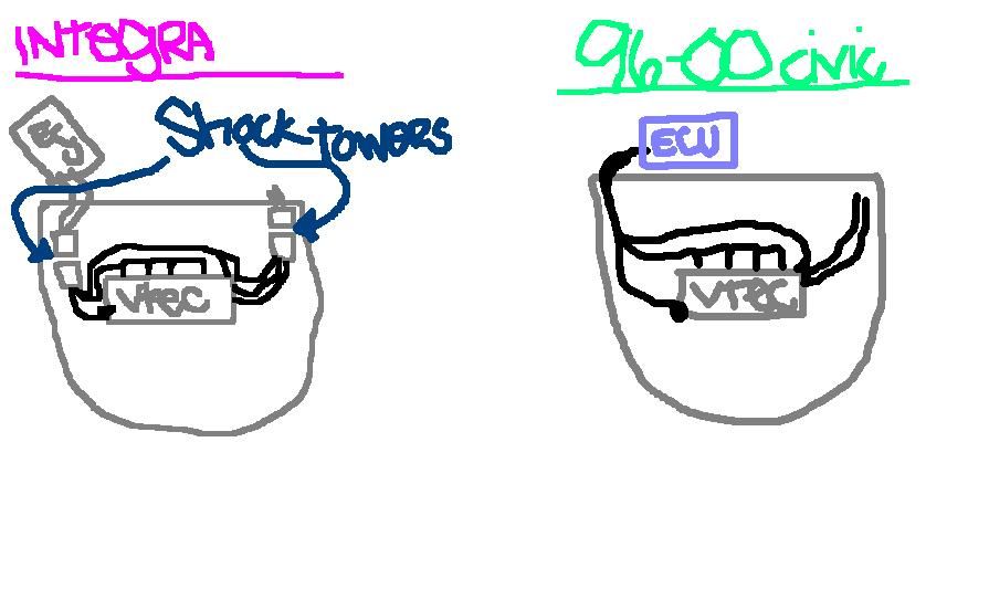

    I'll draw a diagram...

    lol thanks now it kinda makes sense

    I believe what you are referring to as shock towers are actually the bulkhead plugs. The shock towers are the part of the uni-body that the suspension strut top bolts to (near the bulkhead plugs). By the way, nice diagram :D

    Ye ye, but they're AT the shock towers, lol. I was trying to get my point across.
