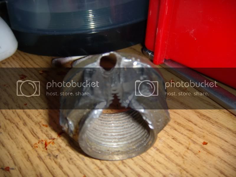

heres a picture of the end result.
very minimal thread damage on the spindle.
ground about halfway through a 1mm sized area on two threads.
