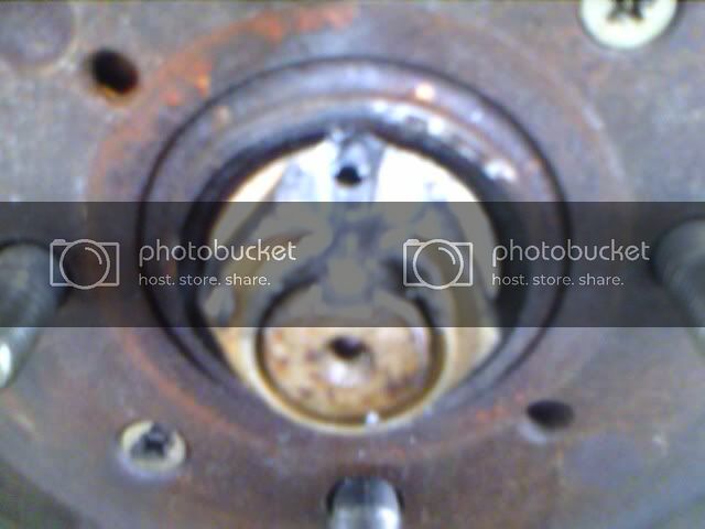

hacksaws, titanium drill bits, carbon steel chisels.. this rotary tool has done a great deal of damage too.
i broke through the back with a drill.

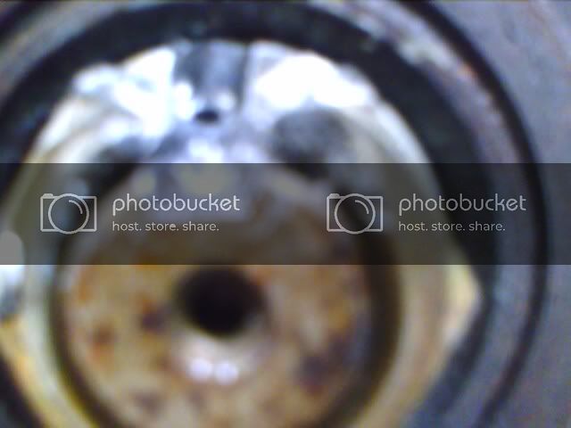

i got like all the way through this bitch with the rotary tool, but i think i started cutting into the spindle too :[
my theory is, itll be easier to get off if i cut through one side of it..

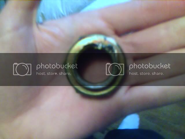

If you successfully cut through one side of the nut, and it still wont move, heat the side opposite the cut and let it cool. That should shrink the side oppostie the cut, or widen the kerf of the cut and make it easier.
before..
after..
