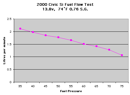

this says it all....
the higher the pressure, the less fuel you are actually getting.
i'm running 860cc's in my new setup, and a stock fuel pressure regulator, at stock rail pressure.

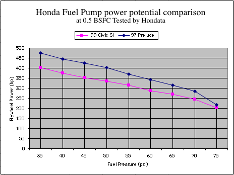

hondata > most of us. I trust it.
http://www.hondata.com/techfuelpump.html
more proof....
higher pressure, less horsepower, all the while starving the motor.

B, you're looking at one side of the equation with your fuel flow graphs.
That's the PUMP'S flow potential. If you have an Intank pump, with an inline booster pump, you CAN use higher FP without adverse effects, and long as total pump flow is still rated high enough at the used Fuel Pressures.
The injector's WILL PUT OUT MORE FUEL when the pressure is turned up. It's pure, simple physics, as long as there is enough pump behind it to supply the needed fuel at the pressure level.
By upping the pressure, they are resolving the issue of not having enough injector. They are jsut putting a higher load and less flow potential on the pump which shows that they had overkill on the pump, but skimped on the injector sizing.
