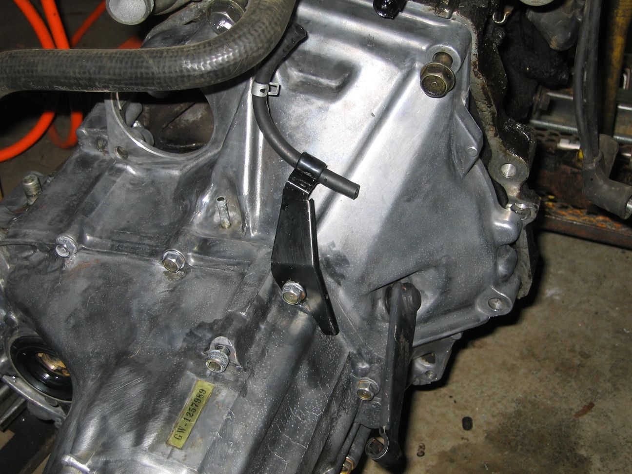

    the 1st gen CRX transmission will not bolt to the D16A6 engine - not even close
    also, none of the mounts will work
