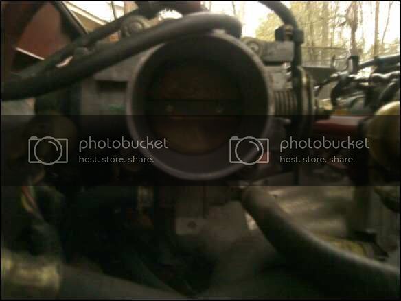

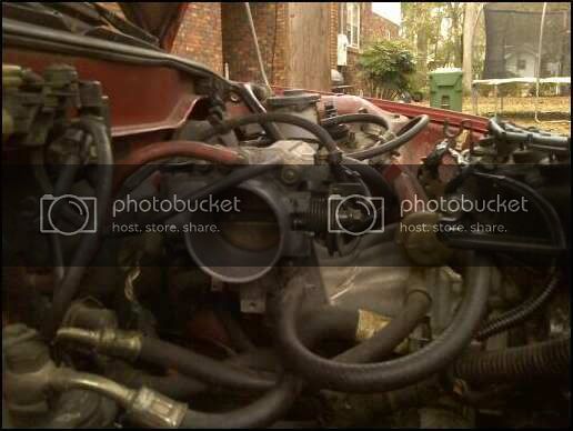

I'm going to clean the IACV for sure but I don't even see the FITV, I don't know if I'm blind or what but I only see just one coolant line plugged into the side of the bottom of the throttle body. Also I was playing with the Evap(?) hoses and while the car was running, like I'd unplug one it would idle high put it back on then its cool. Then I'd unplug another and the car would just die. Not really doing anything significant., just tinkering. LOL

But I don't see any of that on the bottom. I just see the throttle body. My hose looks like it goes into something (but much smaller on the bottom). Sorry for the bad cell phone pics
If it helps I found this picture which looks exactly like it. Do I have to take the whole throttle body to clean it? I'm worried about messing up the gasket.
Thats a OBD2 Throttle Body. OBD2 got rid of the FITV and had the ECU control it.
You have a ECU that doesn't control cold start ups and no FITV to do the job. Find a OBD0 or OBD1 TB.
