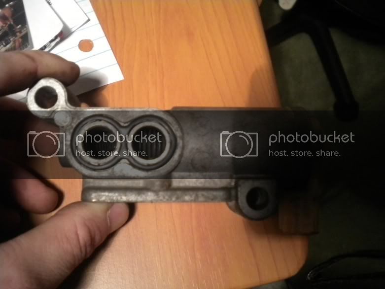

Okay, I took the FITV (located ont the back of the intake manifold) off and cleaned it. However, unlike all of the other pictures I've seen, I've noticed that mine looks as if it were screwed almost all the way in where barely anything can flow in one hole and out to the other.
But since I've cleaned it, it did solve the werid surging idle, still idles a little high, my question is, is it okay to adjust the screw while its running and where would I get a bit from that is a Pentagon? I had one but I don't know where I got it from.
The hole on the right is what you are looking at and referring to as a "Screw" that's adjustable? Or, are you referring to the idle screw on the throttle body shaft that holds the butterfly?

On the left side is a screw that takes a pentagon bit. You see the screw in the left hole and I think it moves the other screw type object in the right hole.
It is not seated all the way but by idling high i mean more like I'm used to it idling around 800 to 900 rpms and not 1100.

My car runs almost back to normal since I've cleaned the IACV ( which is also reffered to as the Valve assembly Electronic Air Control). I just has this slight skip or slight sputter at times which I'll be getting another Distributor Cap and rotor button.
The object shown in the RH hole of the valve is a neoprene rubber bellows that keeps the plunger clean. That thing is a simple electronic solenoid. A coil of wire with a hole in the center that the plunger occupies. When energized is pulls the plunger in and opens the airway. The ECU pulses it open to control the idle speed via bypass air flow.
I am not aware those have any adjustment to them - doesn't mean they don't. I would speculate if the screw does adjust, it will allow for minimum air flow adjustment. Not sure why there would be any adjustment to that valve. The butterfly on the throttle body is the low adjustment and is set with the harness' on the two electronic valves disconnected and the engine at idle fully warmed up.
The part is a IACV and not adjustable from my knowledge.
On hondapartscheap.com.....it's the same diagram picture but the FITV is not available as a #'d option for 88 CRX Si but is available for a 91 Civic Si :shrug2:
I think that is the wrong picture for the 88 CRX Si Throttle body picture because they have that same picture for the 91 civic Si. It shows that there is a port coming off of the Intake manifold for that FITV that is pointed to the firewall. However Mine is not like that. Plus if you switch from the Throttle Body(2) page to the Intake Manifold(2) page that little port disappears.
