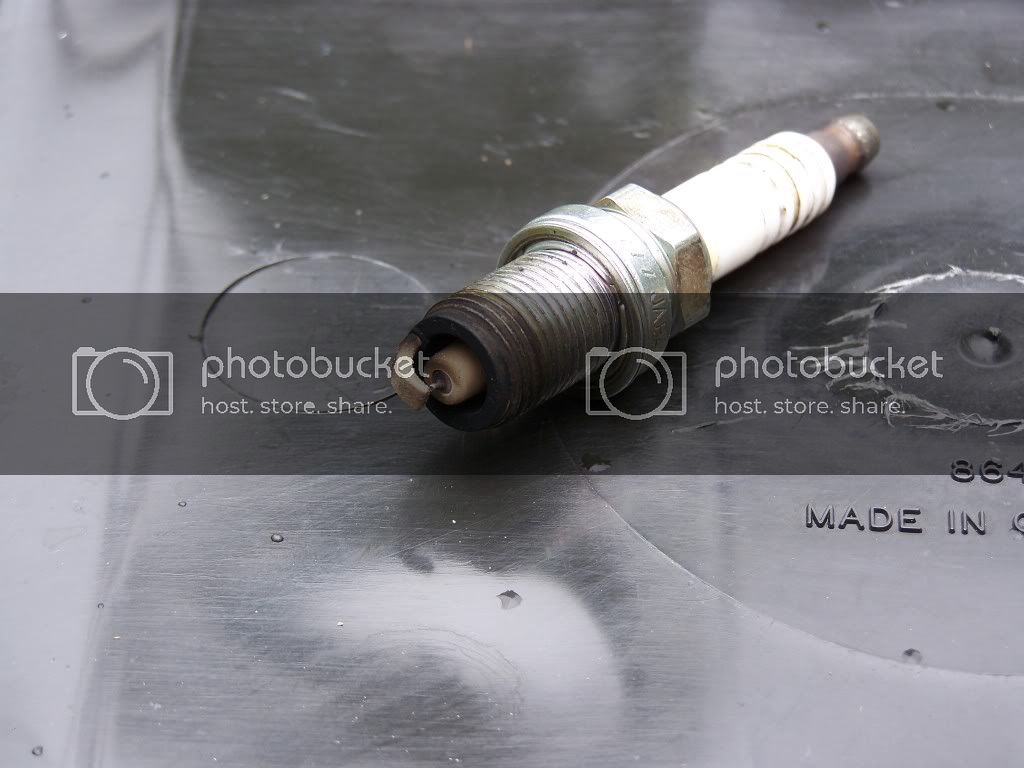

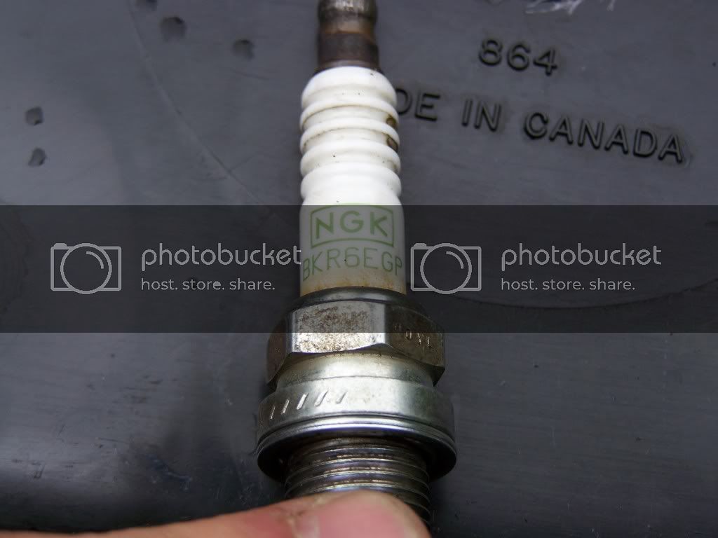

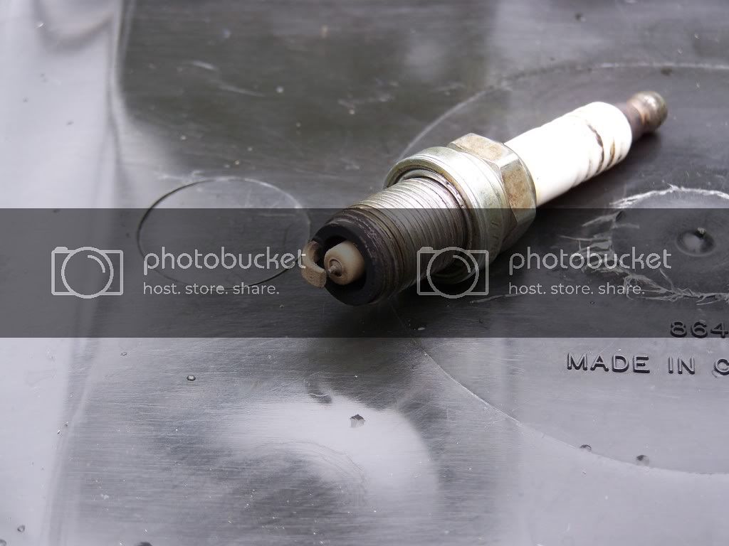

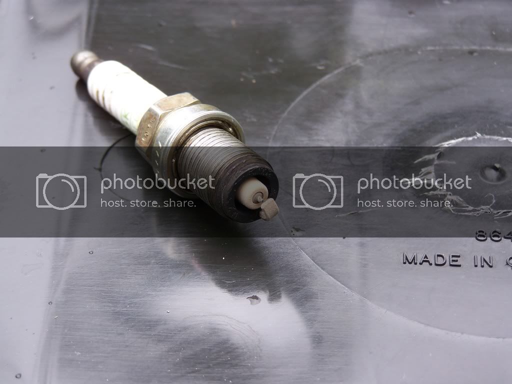

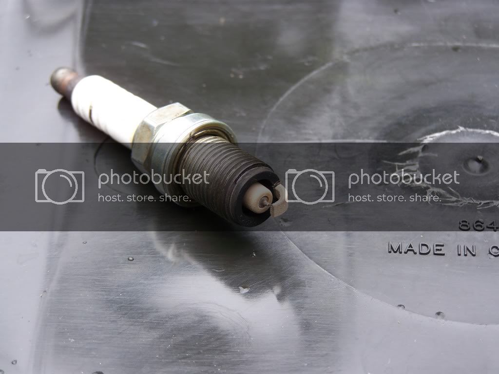

    I made a cold start video and took pictures of the plugs right after. The effing thing backfired through the intake!! And you can see it bogs hard in the low RPMS, but after 2-3 minutes of running it cleans up.
    YouTube - ‪B16A Cold Start Studder‬‏
    Plugs in order from timing belt to dizzy.

    EDIT: I just listened to it - has all the symptoms of weak ignition. Check battery voltage and charge condition from alternator. If ok, tear into dizzy.
    If it's weak ignition it'll drive ya nuts. EDIT 2: Plugs look awful clean - maybe wait in dizzy till you check voltage of battery with it running.

    How old are those phuking Spark Plugs? Replace immediately! Gawddamm!!!
    The top caps on those look like they may have came out of a 1953 DeSoto. :)
    What condition are the plug wires in?
    Oh, and when you replace the plugs put some permatex anti-sieze on the threads. Always use on spark plugs - especially with aluminum head. Torque should be ~13 ft. lbs.
