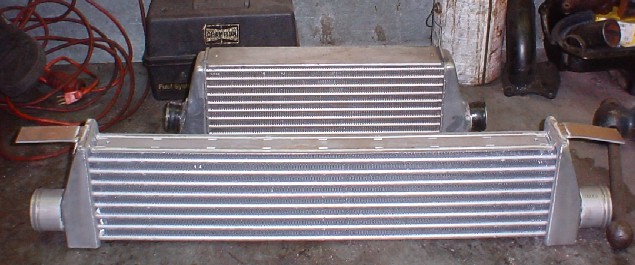

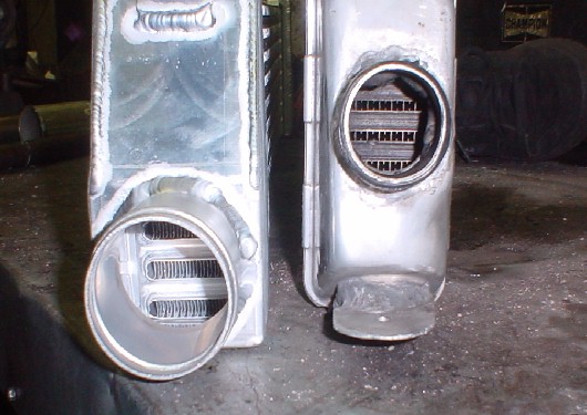

weve got a few guys on the mirage board that have swapped from johnny ICs to starions... because they are better... loco is right about them acting backwards later on in the gears, and if i can find it again ill post up some thermocouple results from a friend that has a built turbo 1.8L from north east auto designs in maine.
the starions looks tons better anyway. ill be running just a basic 1g DSM sidemount... cheap and budget but enough to work. B)
Oh yeah the starions look much better lol... :roll:
So now efficiency is determined by looks? Sorry man factual scientific data works, opinions of appearance don't.
You are an asshat. Looks don't determine performance. Otherwise, front mount intake IC look-a-likes would give you a bajillion horsepower. You make me embarassed to be from western Washington.

Well, what the fuck are we supposed to do... you say "Oh yeah, the Starions LOOK so much better..." and then you post two pictures. What the fuck, man? What the fuck do you want from us? Are we supposed to glean flow rates and pressure drops from that no- brained post? From the content your festering belch of wisdom contained, I'd say that you're more concerned with LOOKS than anything else. This shit might fly on Honda Tech, but not here. Know why? Becuase I'm right and you're wrong and there's not a fucking thing you'll ever be able to post to prove otherwise. You've had more than a chance. You've posted nothing but insults, pictures, and speculation. Go re- read this thread and see how many people are saying you're right. There's only one. You.
