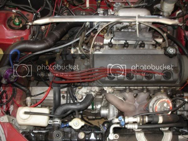

    There's a lot of ac and ps friendly turbo mani out there! Most are cast iron though but I did a set up exactly like yours with a Rev hard mani.. It's the downpipe that needs to be fab to fit the ac compressor! [​IMG]

    thanks for the pic! gives me some ideas.

    NO problem! It's my friends car but I did the fabricating! I also did it to my girls eg8 with a b16, also with ac and ps also! It just matters on the downpipe and the and the manifold!
