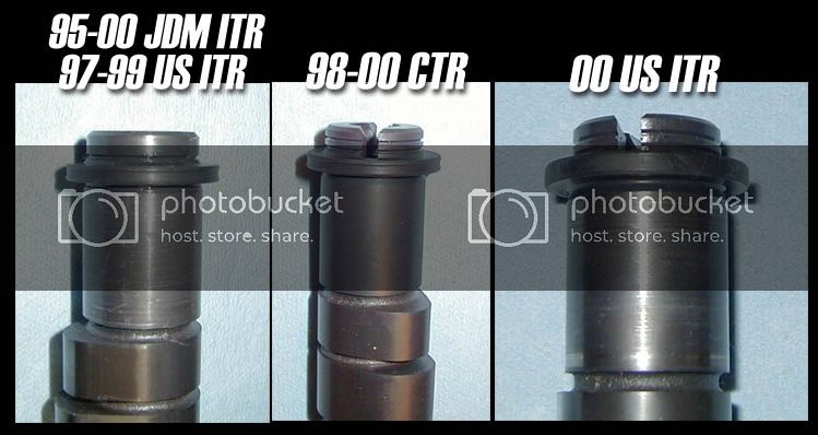

Okay...I found a picture that contradicts me. Look at the intake in the middle picture
EDIT: It says CTR and I thought they all said ITR.....Fail
Lol I have that pic too. I just didn't post it because I thought the one I posted was the better picture lol.

00+ itr intake cam (P73): 7.365mm lift, 191.52 degrees duration
CTR intake cam (PCT): 7.365mm lift, 193.45 degrees duration
This is for the vtec lobe. The small lobes are identical for both.
