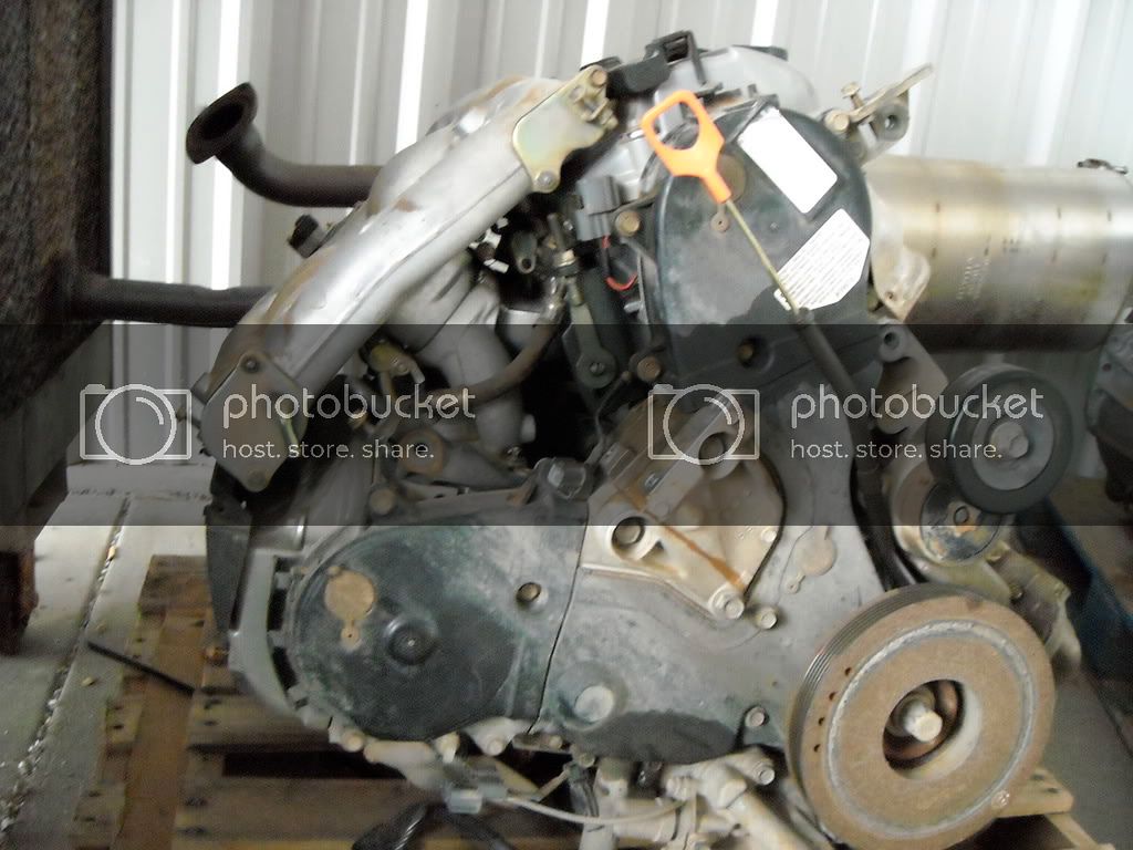

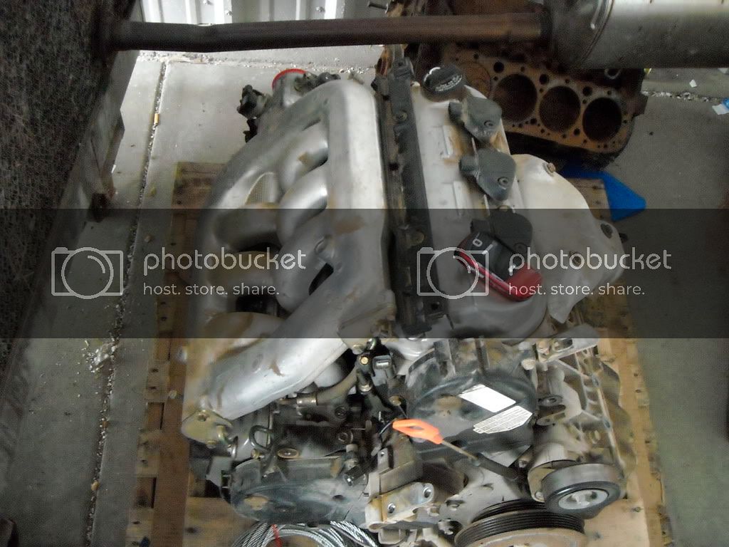

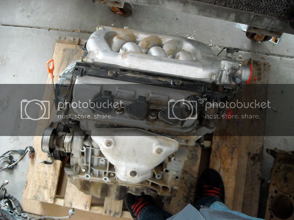

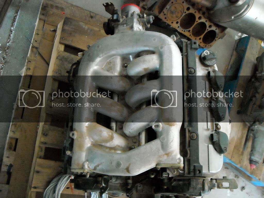

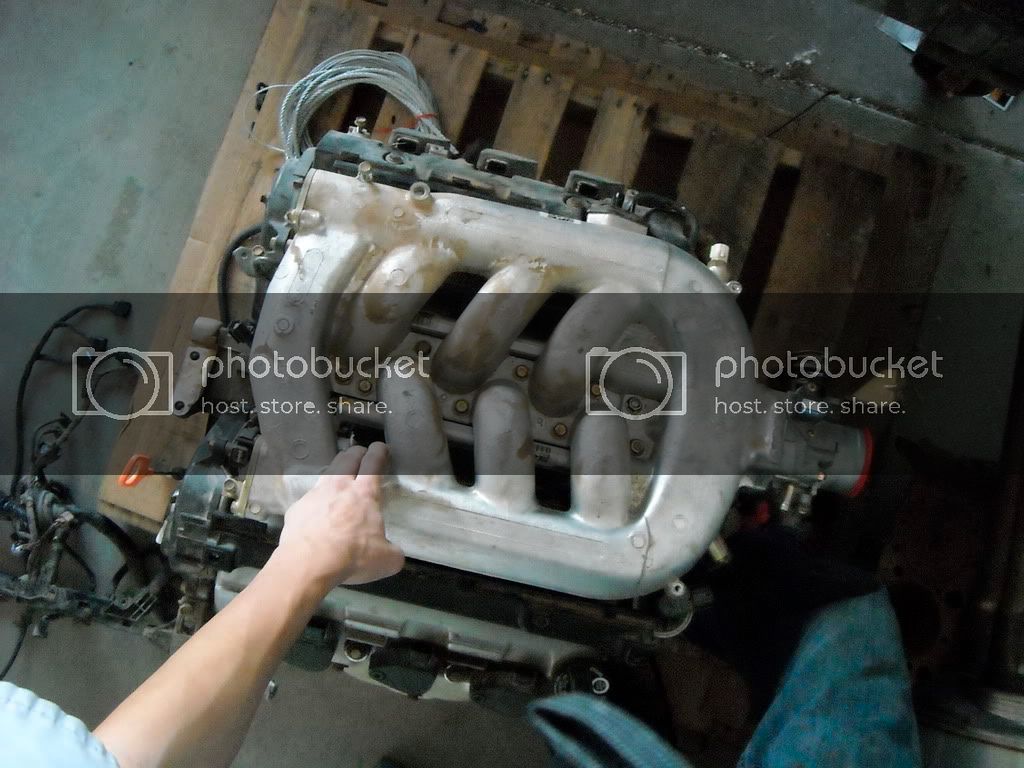

Here is a few pics of the J35, i dont know when ill be able to take it apart and re build it, but i will post pics when i do.

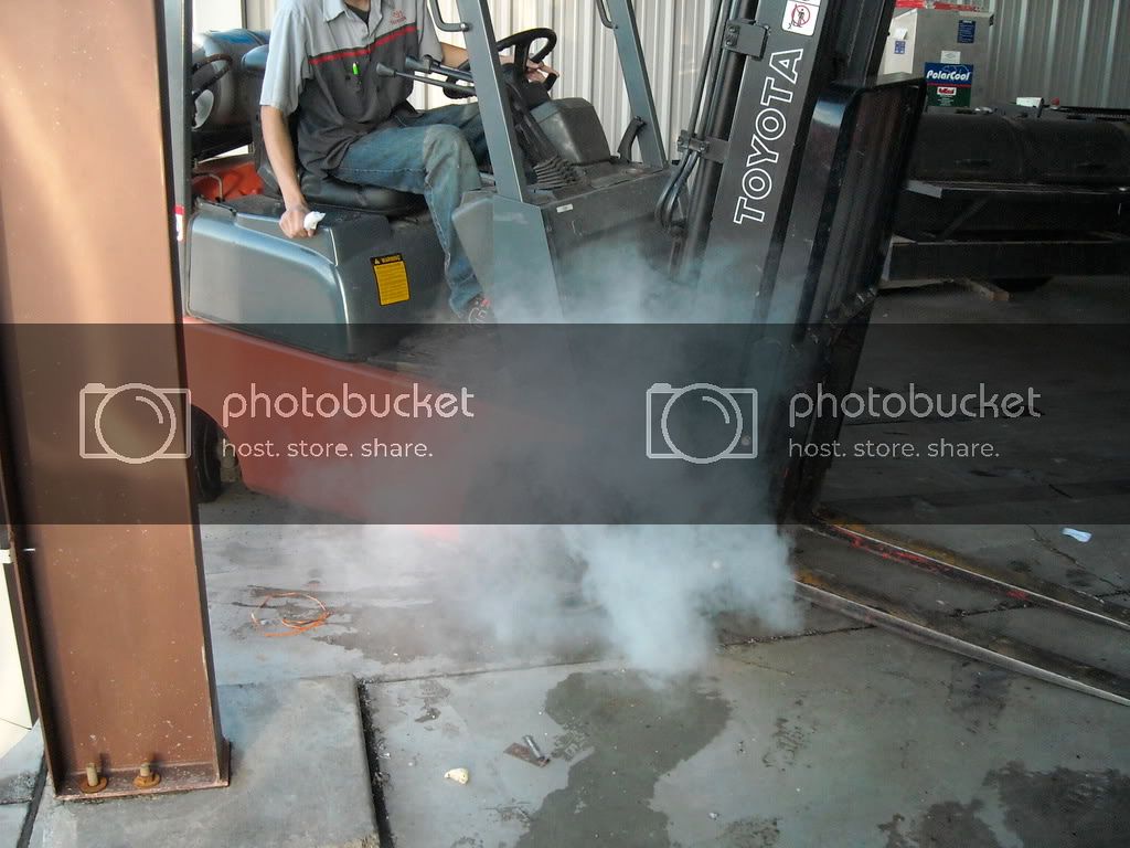

And got bored At work....:D

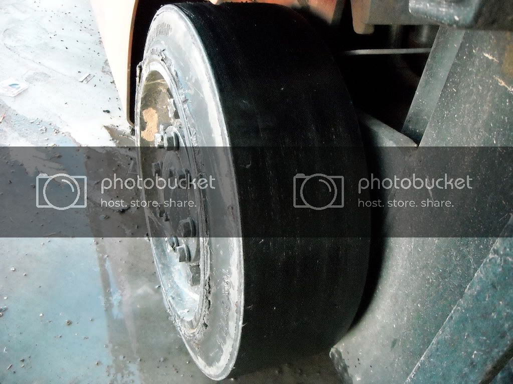

look at these Slicks...:p
Hopefully your tires were due for a change, if they werent they are now. All good fun tho.

I just picked up a J35A1 out of a 01 odyssey for free from work, the motor needs a re-build but no big deal. ive hear/seen the V6 swap into a civic, i hear hasport has some mounts out now but for the 3.0/3.2 i think, i was wondering if the j30 and j35 share the same block, like where every thing bolts up and what not.
