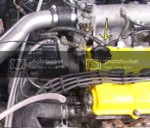

this is the oil breather line
normally it connects to the air intake, should put it before the turbo or between the turbo and the engine?
if you didin't make positive boost (which you wont putting around at idle) obviously the bov isn't going to do anything-- there's nothing to bleed off.
as for your Vac line, just get apc breather filter for now...
then save for an endyn catch (and only an endyne can-- all the other 2 pot ones are useless- you need a 3-port) can to replace the pcv system and you'll use that port.
