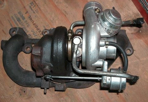

    One of these:
    Mitsubishi TD04 for $100....
    My question is this: I'd like to grab the intercooler as well...but will it fit in the empty space left by my a/c condenser?
    Does anybody know the dimensions for a '91 civic a/c condensor? The volvo intercooler is 29" x 17".
    Would it be worthwhile to cut off bottom 1/2?
    Help would be awesome. m(_ _)m

    I think I'll have to go back. All I took was the turbo & intercooler (which probably won't fit). Don't know why I didn't at least grab the blow-off valve. You don't really think I could use the injectors, do you?
    I've been scouring the web for information & help. The first hurdle is going to be the manifold. Secondly, this is a water-cooled unit, so I need to plumb in water & oil lines in addition to the exhaust & intake pipes.
    Whew. Hope I'm not in over my head here....

    Use the water-lines from the throttle body, and a popular way to tap the oil supply is to add a T to the stock oil pressure sensor. Some people use an oil filter relocation kit, and run the turbo in-line, but that's a bad idea because hondas have higher oil pressure than the turbo is rated for.
    Just make sure you use a line from the back of the block to the T that you mount the line to the turbo, and the oil pressure sensor. Don't put a T directly to the engine, then run the stock OPs on that. It's too much stress on the fitting, and you'll break it off. Some people like to run an oil cooler somewhere in their system with the addition of the turbo, others say it isn't needed. Take into account your climate, and how hard you drive.
    Water is pretty easy. I'm going to tap the lines right from the head. I've already got everything bypassed (TB and IACV), so it'll be just a matter of running the lines.
    On your turbo, you'll need the banjo bolts/nuts. Make sure you clean out the lines you got with the turbo before you mount it up. Ensure you're getting enough flow through the water-lines. The oil isn't too big of a deal, because you're going to need a restrictor anyway.

    is it the intercooler in the picture above? it doesn't seem like it could be that big considering that looks like a side mount from the older nissans....but anyways if it is bigger than the battery and air box combined then there are still some ways to mount it you just have to be creative when you do it like you said. when you get it post up the dimensions.

    Same dimensions as the pic, but inlet/oulet are mid-mounted instead of top mounted. 29"x17" Like a barn door. Think about the old volvo grill....about that big. (^o^)
    I'm really looking forward to this. I still need to get back to the yar for BOV, piping & injectors. Then I'm slicing & dicing cheapo Bosal headers & down pipe to fit. Whee!

    You have the blowoff valve. Its on the compressor housing for the turbo. Thats where the valve is on my 760 wagon as well.
