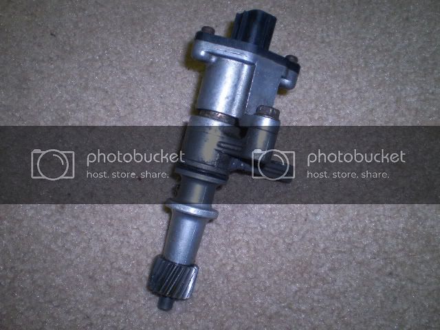

is it the part marked "6" that you are referring to... the gear on the end of this
or
the gear inside the tranny that it meshes to?
if it is the gear in the pic then that i believe is called the "speedometer drive gear"
as far as the one in the tranny that it meshes with... not sure the name or if it is available
