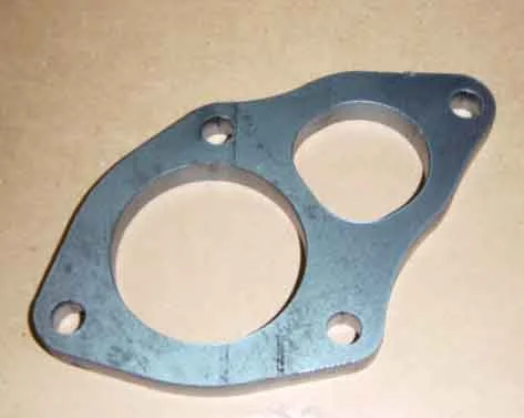

You can remove the flapper valve and the actuator and have a separate AFTER turbo pipe welded onto a two port outlet flange. Lemme see if I can find a pic. Basically you're leaving the stock Internal WG port wide open, and stopping the gasses with the external WG after the turbo.
Here's an example flange picture. The smaller port is the WG outlet, the larger is the DP port. If you put the wastegate AFTER the turbo, it regulates boost just like an internal gate, just a good bit more effectively, and reliably. :)
