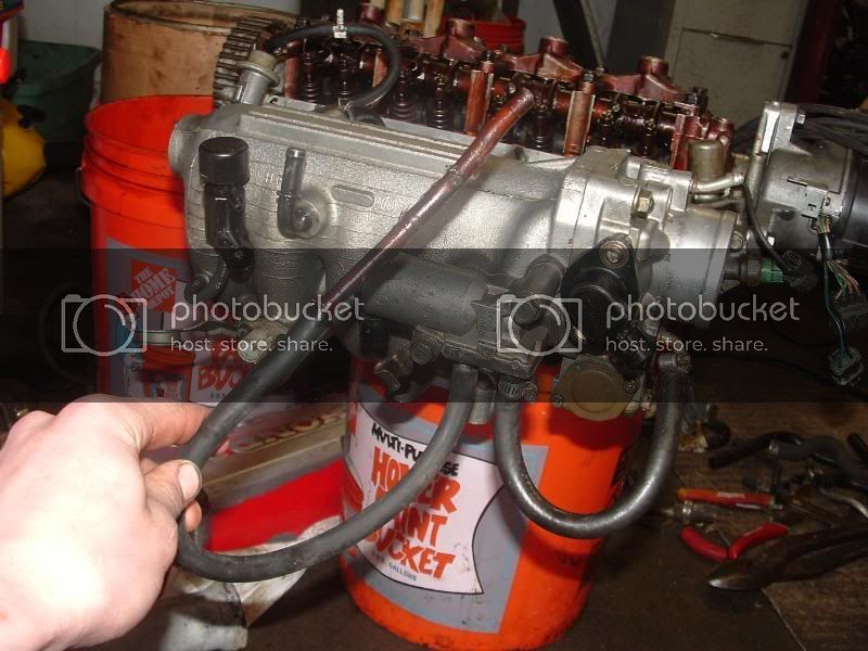

were does this hose go
kermit5327
Member
ok so here is the thing i have this hose and no one can tell me were it goes. when my car is at operating temp it blows steem out of it and my car over heats. so i stuck a stick in it cuz one of my buddies said it is just supposes to be blocked off but that dont sound right . weird thing is when i stuck the stick in it the car stopped over heating
WOW! Your friend is a retard. That would be your IACV. That needs to be hooked up or yes it will make your car overheat because its just going to dump coolant everywhere. There is a little nipple on the coolant tube on the back of the motor just above the oil filter, it goes there.
PS Dont listen to your friend anymore.
yea i think i have figuers that out it seems to be he is a fuck tard but thanks for the help when i get the head back on ill see if that works
Coolant inlet hose for the IACV. You need to find the feed line in the car and connect them or just replace with one single hose.
